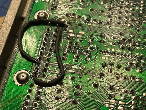

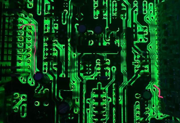

When the caps C18 or C40 leak it can damage one of two traces that can make code 22 come up. See the red lines in the first image and test those traces and the repair I had to make in the second image from the C18 cap damange.
