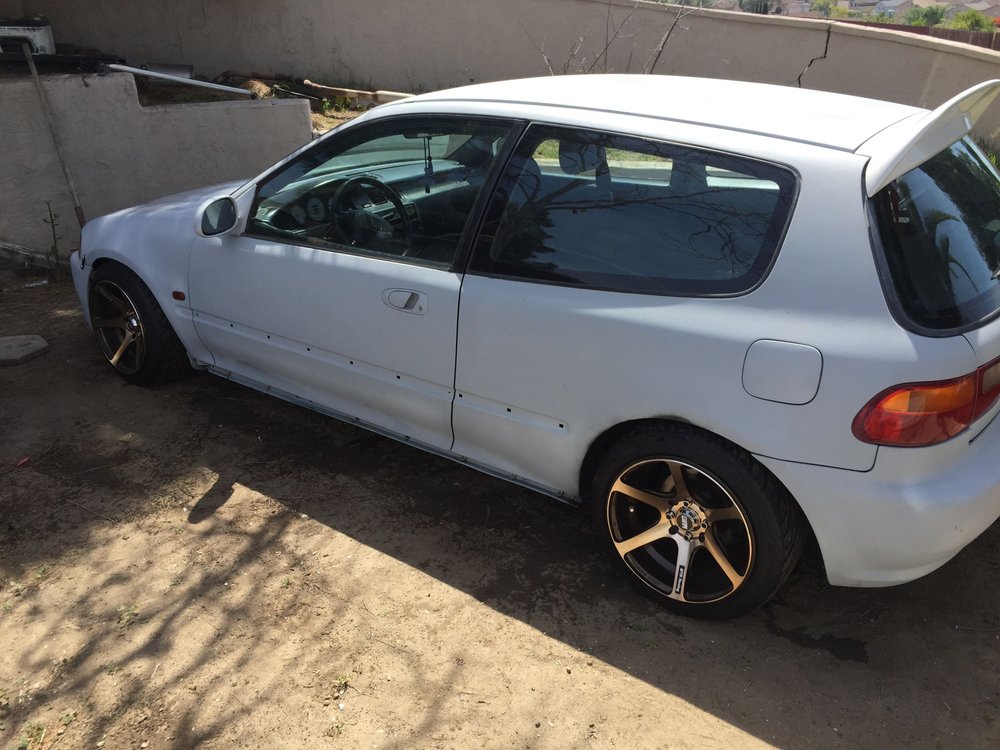

Default Re: Slowly resuscitating a 93 hatch
Got some 15" concave STRs on the low and put it on the baby

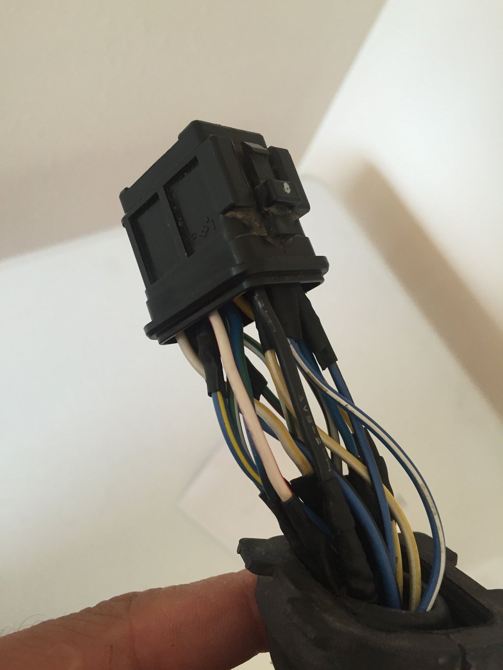

Now back to the doors; went mining for interior door harness and low and behold found an ex... But with chopped connectors :/ took about 2 hrs to remove. Had to find a sedan and clipped off the connectors :/
Going to compare wires.. Removed bigger gauge wires which I believe ran to the back of the sedan. Still have them in case.
Soldered and pinned the wires!!
Both harnesses ready for install.. moment of truth for sedan door internals into hatch to come!

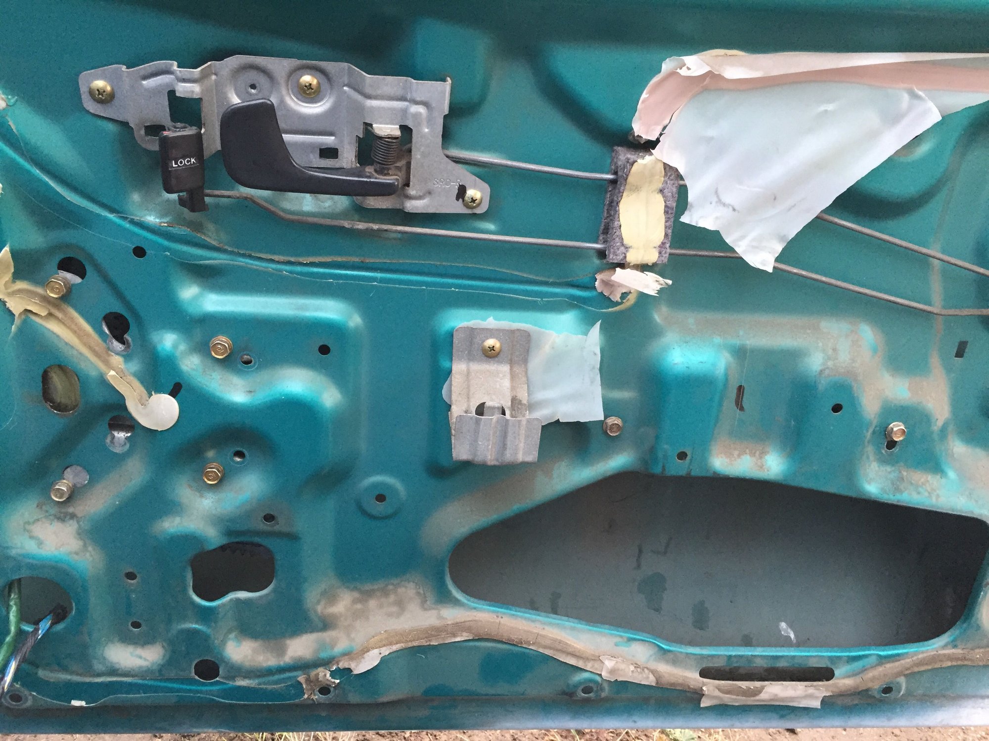

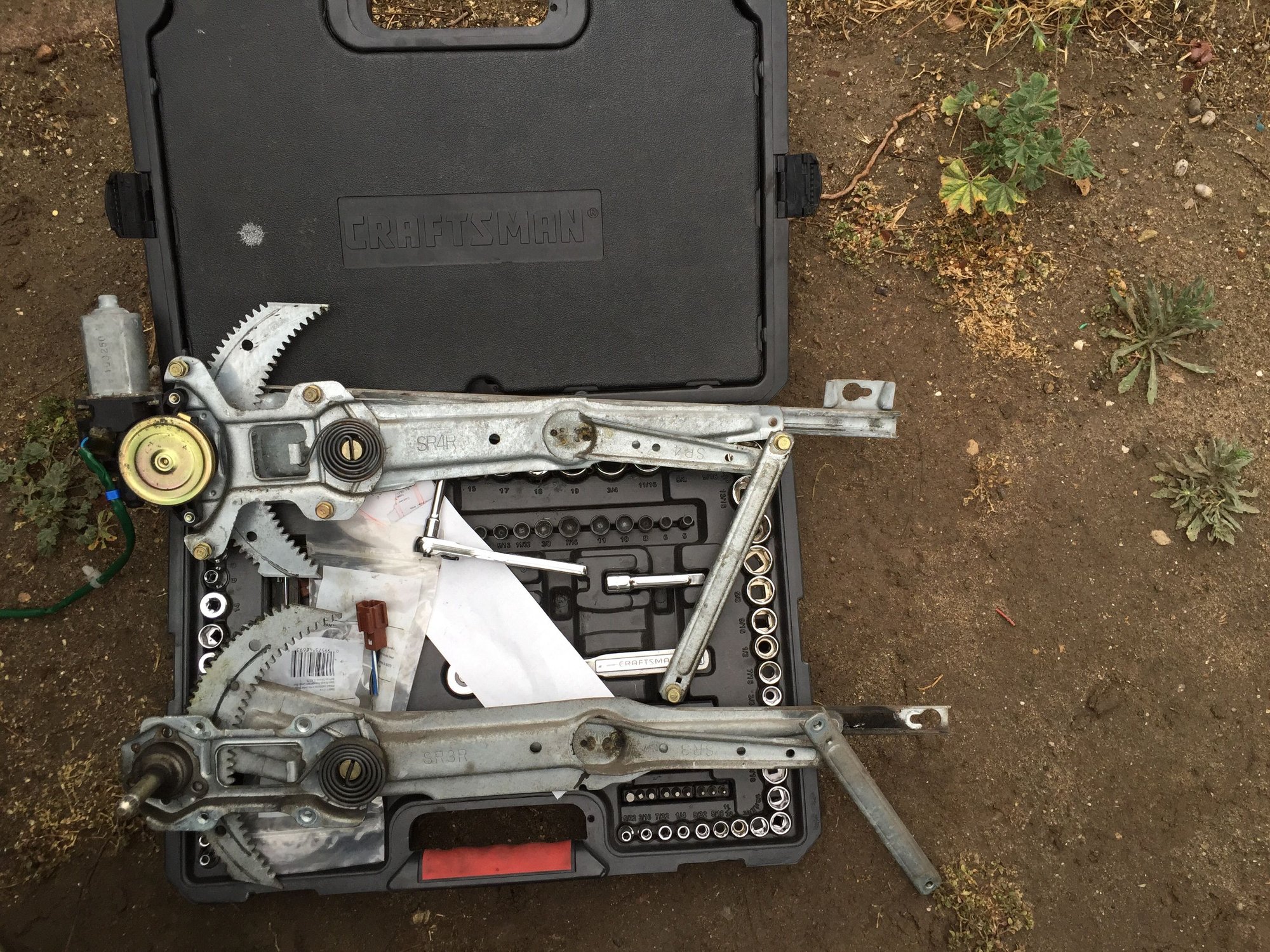

Old May 8, 2015 | 06:08 PM
edwinie26's Avatar
Joined: Nov 2013
Posts: 189
With a little swapping around they work! Not direct bolt on but easy to do. Sedan power window assembly in a hatch! Shame on those that say it couldn't be done!
Sedan window assembly in hatch works with slight modifications

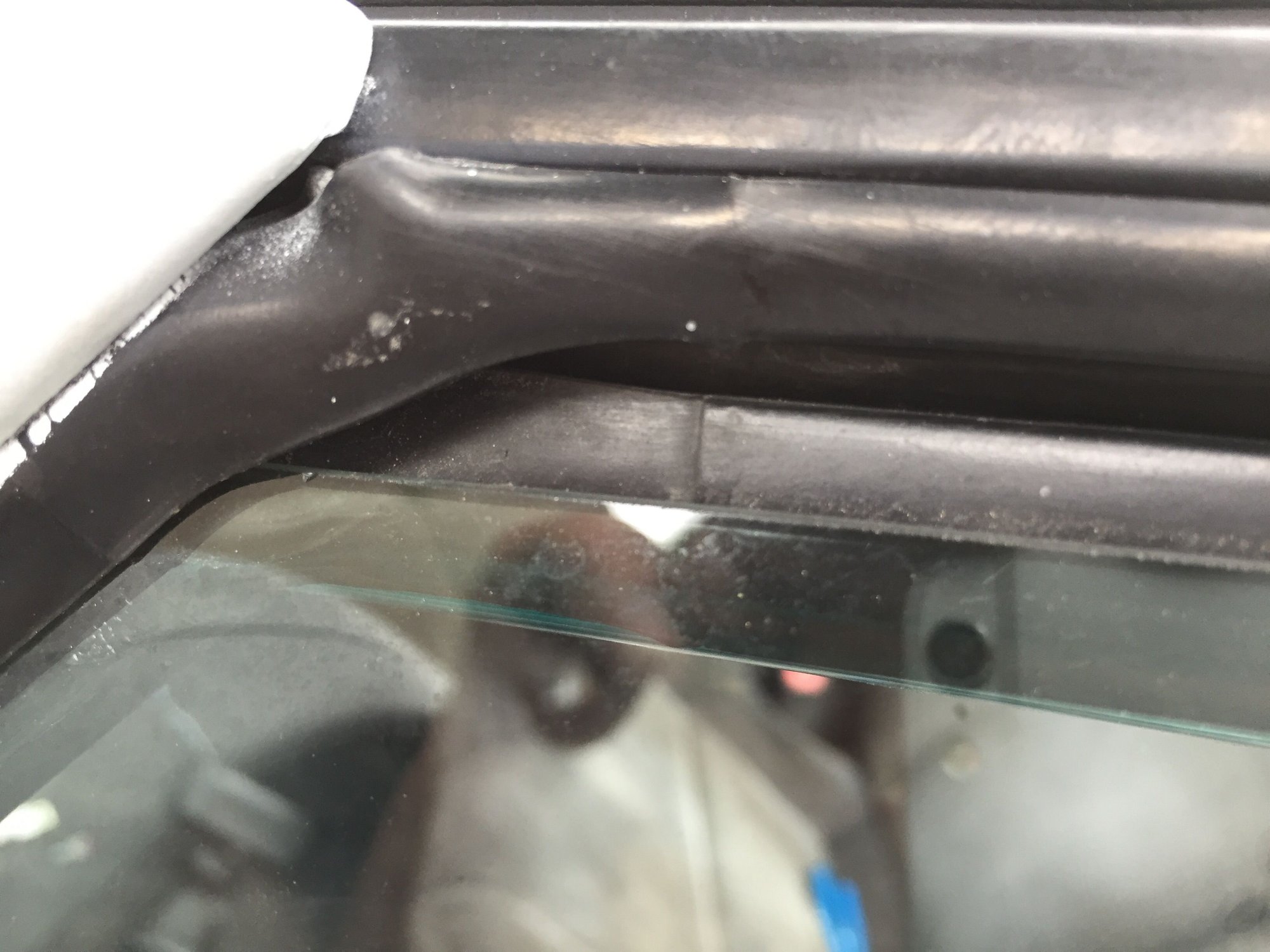

Only downside about the sedan front window assembly in the hatch is that it doesn't close 100% it still closes but only to about half of the weather strip
In person it doesn't look so drastic as this picture haha. Had the extra parts laying around and thought, why not. I'm sure I can get them to close 100% but this is for the mean time

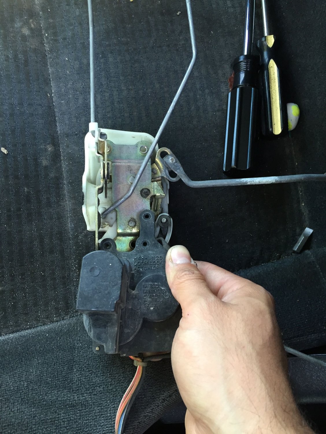

Soooo.. Power doors installed oh yea
All you need to do is swap the actautor. The picture shows it removed from the sedan assembly. If you have a steady hand you don't need to remove the manual one at all.
