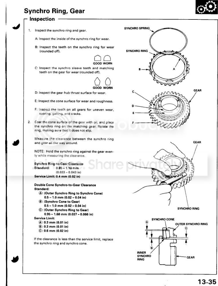

If you want to get some more pics, get some pictures of this stuff.
so we can see the condition of the dog teeth and part of the synchros:
Inside of synchro sleeve:
inside of synchros
The more pictures you take and post, the more we can help you

Default Re: (_eoN)
Man, that sleeve is toast. I've seen shift forks much worse than that.
Mic the shift fork where it contacts the sleeve to push it up or down at the thinnest portion. The service manual should have a minimum spec for the thickness of the shift fork for that area.
