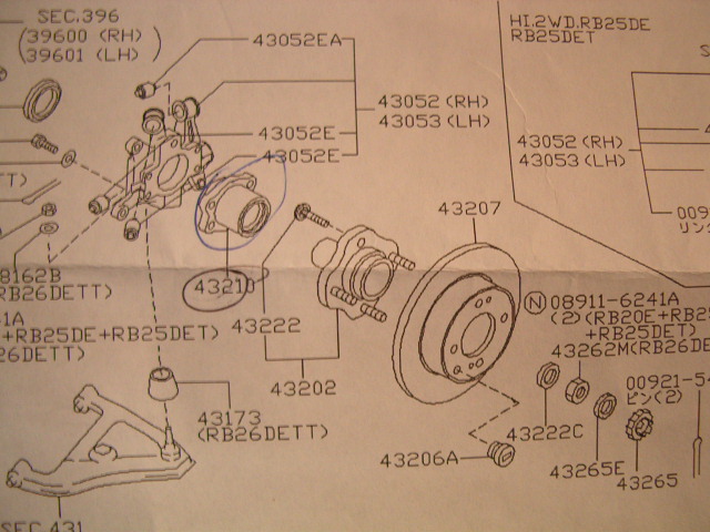

Here it is:
As the first picture shows, the bearing hub is bolted to the wheel hub by 4 bolts.
The stud assembly is pressed into the bearing hub.

its part way off the spline so thats good, try some wd-40 or other penetrant to hopefully act on the rust, let it soak for a while too. Heat could also help, dont use a torch though, you run a high risk of getting the spline axel too hot and ruining the heat treatment, an electric heat gun will help hair dryers dont do anything they arent hot enough. try a rubber mallet and tap the hub back onto the spline. there might be a retaining ring its caught on. check the diagrams for a view of the spline, if thers a groove drawn at the end Ill bet theres a retaining ring
