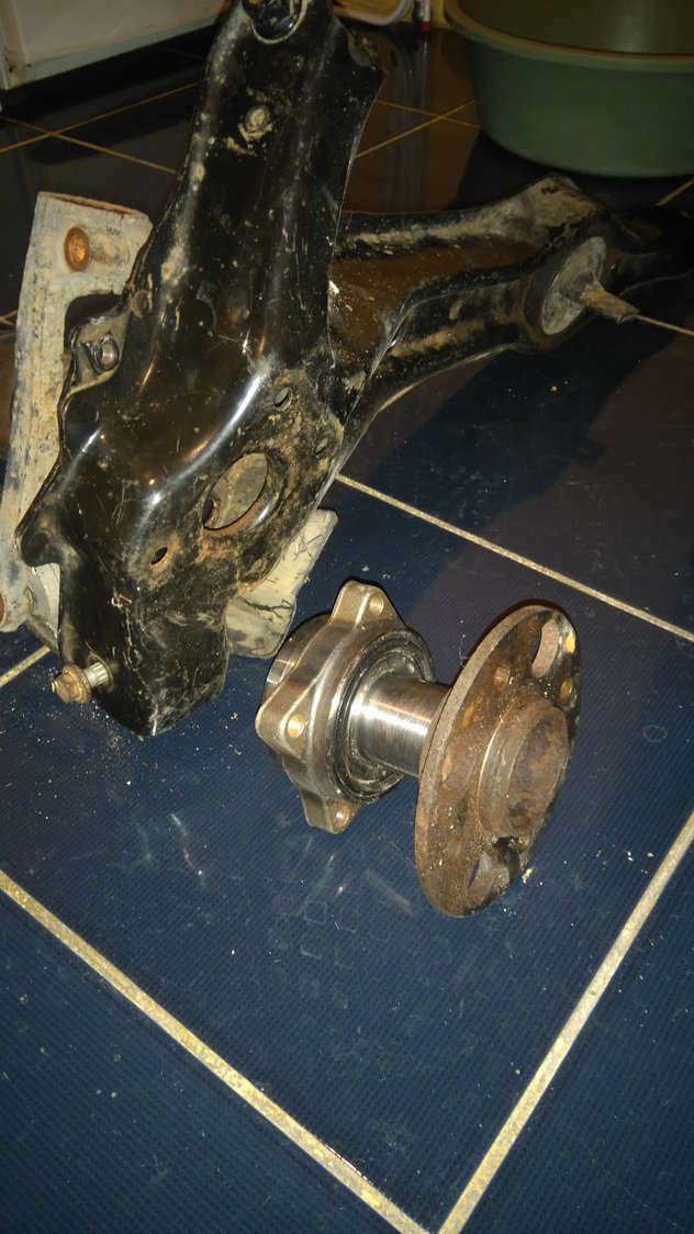

Reworked stock trailing arms, adding a bracket to accept Accord 4th gen front bearing,
Reworked 4th gen RTSI civic rear Hub(done) to fit the 43mm ID bearing.

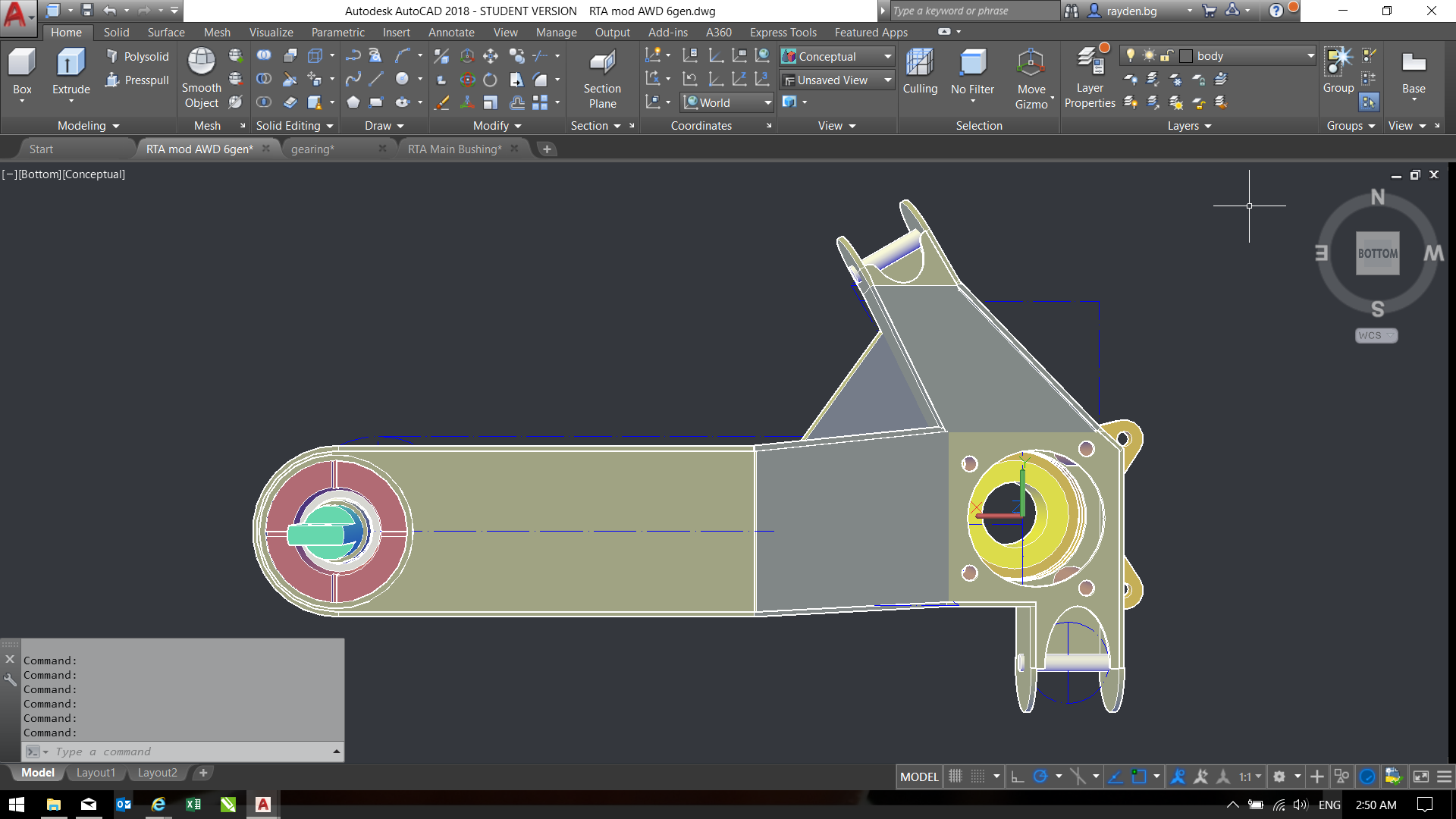

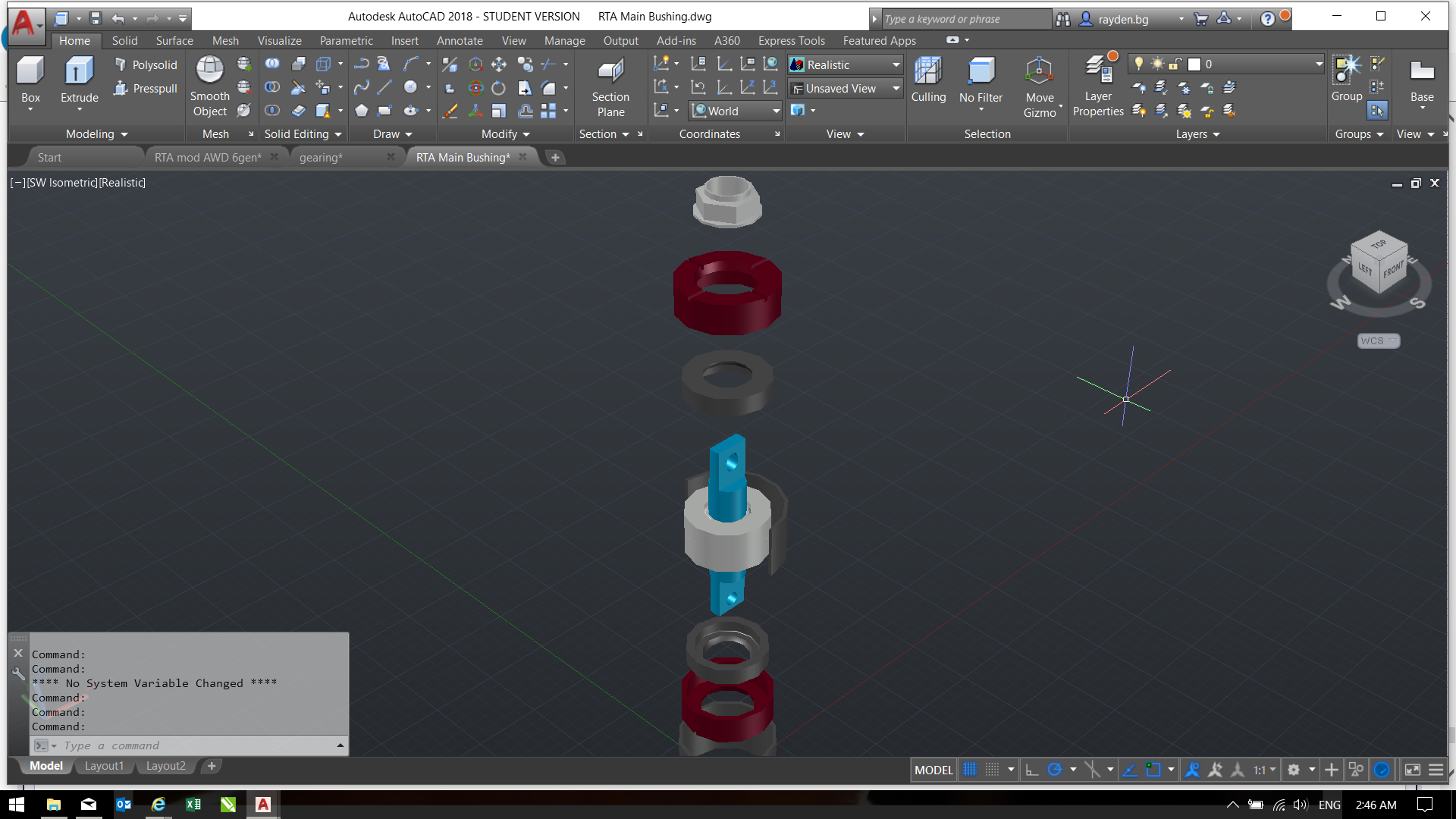

An update on the rear suspension,
The cornerstone in the project.
REAR BEARING BRAKE BRACKET 3D in AUTOCAD. the first OEM not available
hope the guy from the machine shop have time for my project and make this babes real.
This 2,4kg billet steel piece will carry the accord front wheel bearing on it, so copy the original knucke bearing dimensions only upgrade to thick walls as it will have huge hole trough it, and add the 4 bolts for the Bearing.
Printed the blueprint, checked, it all fits like a glove over Milady´s hand!
The Bracket, Bearing and Hub, are the most stressed components of the whole suspension as well further they pass the tension to the TA, therefore absorbed partially from the bushings to LCA, UCA, from LCA split to Shock Damper and chassis.
So everithing has to be as much possible near the stock. You change thiny bit in the geometry you suffer shassis structural rigidity and stiffness loss, Therefore, new bushings sooner, new this, new that more than often. So you´d better buy yourselfe Euro brand new car.

As you observe the TA is stock civic 5,6th GEN!
THIS IS NOT a shortened version of the RTSI TA!
Already mentioned don´t want to loose strenght in critical component so minimal welding is recomended and not where it can bend, broke stitch, whatever..

HUB from Shuttle 4WD, has the same splines to match CRV CD Joints. Only OD is 34mm,
What was done
Hot Inserted steel pipe than machined to 43mm Bore 44mm Spigot of the Hub.
You need 0.1-0.3mm on the hub being tight (wider) than the bearing. As you do need to press fit it in the bearing.
Yet again machine shop guy is quite bussy at summer.
Every ricer in the town wants a new spoiler to make his car run faster...

was working on the trailing arms,
finally got used to all new stylish ACAD2018 and got this brand new 3d trailing arm
RTA Outside RTA inside Isometric
Bearing, Brake adapter plates,
SET Main Bushing and Bearing Assembly First Cardboard mockup.
Then plasma CNC, welding,
I hope within a week to have the rear beam also finished design.
