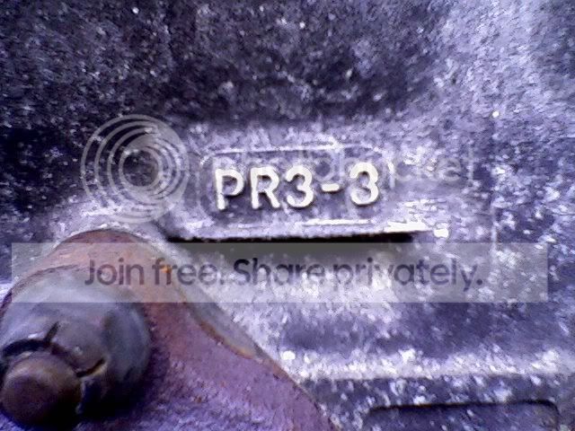

I'm trying to help another member out, he needs to figure out what distributor he needs for his LS/V. He tells me he has a PR3-1 head which I assume is a B16A head but is it A3 or A2 or what? JDM maybe? This is the info I have come up with but it's not cut-and-dry, I have included a pic of my head # for an example:
PR4/P75 - B18B/B20
P72/GSR - B18C(1)
P30/PR3/P73 - B16 OBD0 - B16 OBDI/II - ITR
<u><FONT COLOR="red">(I believe this info is correct, someone please chime in if it's not)</u></FONT>
Head # can be found above and to the right of cylinder #2 exhaust port.
Mine is a 92-95 SiR-II B16A PR3
