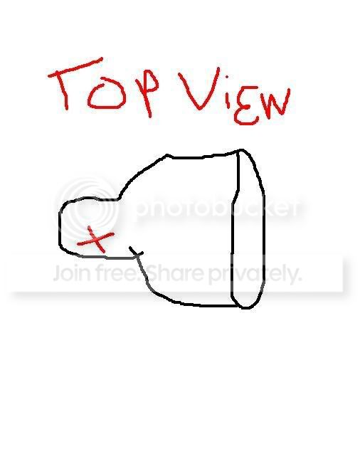

Default Re: Need help on which tranny to use (Mikey3000)
not the best looking picture but i was too lazy to get a picture cuase the tranny is at a friends house.

Default Re: Need help on which tranny to use (Ahknodd)
Nice pic man... didn't see that the first time, so since it's that half of the case you can just pull that off and put on the other one and it should work fine. I would check with others first, just to be sure, but I did that same thing and have had no problems. You won't need to swap gears or anything since they're all stuck to the bell housing side (the part that attaches to the block).

if i were you, I'd put the ex guts in the cx case.
if you have a 92-95 ex trans, use the 94 cx case.
if you have a 96-00 ex trans, use the 96-00 cx case.
the 97 cx is much better gearing than the 92-95 cx.
the 96-00 cx trans has the same 1-5 as a dx trans, but a 3.7222 final drive.
if you chose to swap the gears into the cx case, pm me and i'll give you more details.
figuring out a way to repair the hole in the casing is going to take more time than a simple case swap.
