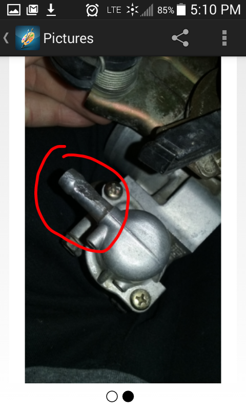

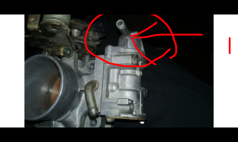

Its part of the throttle body deicer and id rather not have to get a whole new throttle body.....

Do they have parts for it tho i dont wanna buy that either mine works but the nipple is rotted

This is what i need

Saw off the damaged nipple, tap the hole 1/8" NPT, and screw a brass hose barb in... in place of the damaged part.

Definitely that, or just make a block off plate for it

They dont sell that part seperately. You have to purchase an entire Fast Idle Control Valve.

wow ty finally a usefull comment, yea i pulled it off a junked 94 with 88xxx miles it was almost perfect. $2.18 and a can of carb cleaner later it was fixed
