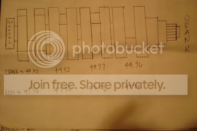

ive micrometer my d16y7 crank and the inside of my eagle rods and these are the numbers i got. i was wondering what bearing i need. i will be using OEM honda and i need to find out asap so i can finish my build.. HELP ME PLEASE

now you need to measure ID of the torqued rods and mains. then you do crank OD minus rod/mains ID. then you can look at this chart

then you substract the previous total minus x2 of the bearing you want to use, whats left is clearance
and you have to use a micrometer thats goes to .0001 or lower

The way i figured it there isnt an oem bearing thin enough.

i did that but those are the numbers i got..
