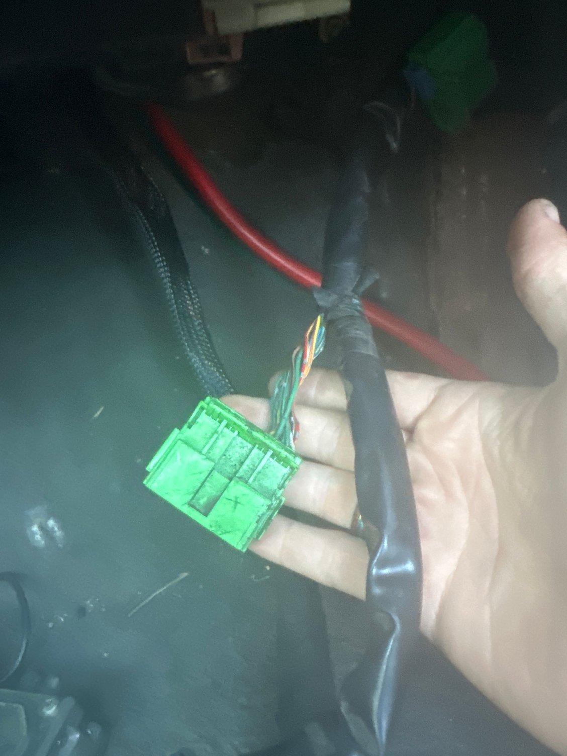

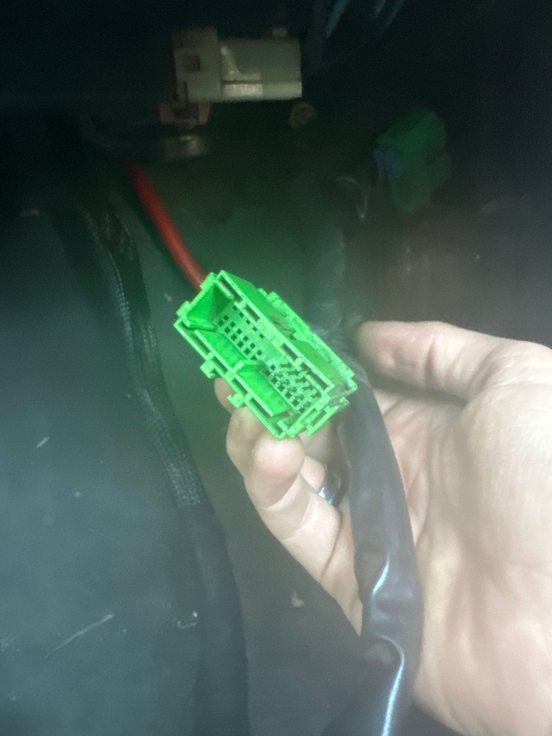

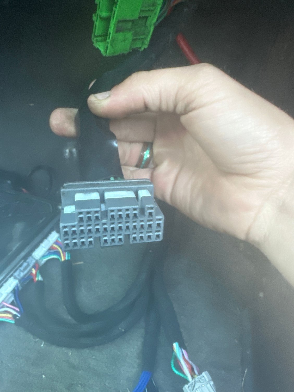

I have attached pictures of the connectors I need pin outs for, any info is appreciated

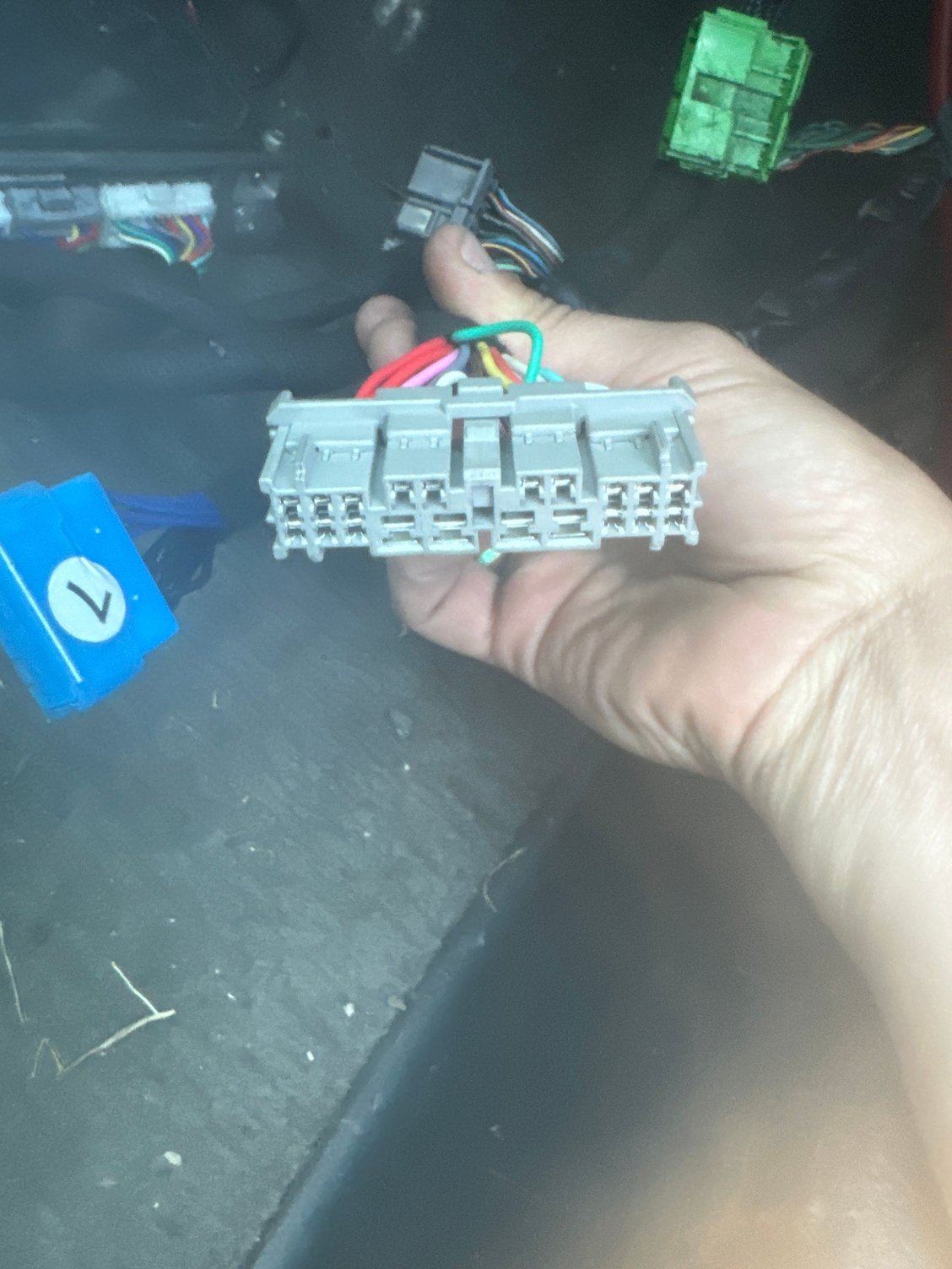

I’ve also added a picture of the obd1 engine harness connector if anyone can get me a pinout for that as well.
Not 100% on what this connector is but I need a pin out

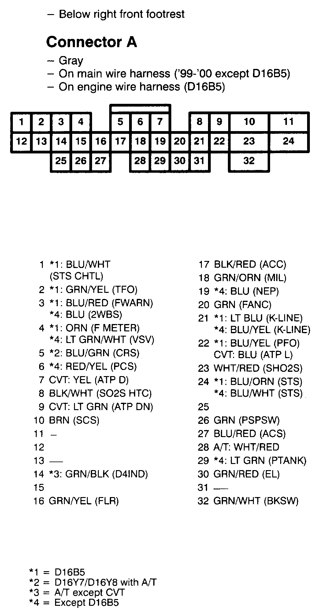

Obd2b connector A I believe (need pin out)
Obd1 b series engine connector (need pin out)

Thats the top grey plug
