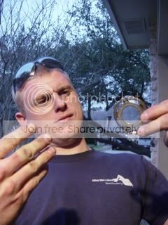

<TABLE WIDTH="90%" CELLSPACING=0 CELLPADDING=0 ALIGN=CENTER><TR><TD>Quote, originally posted by deftonerider &raquo;</TD></TR><TR><TD CLASS="quote">did you reinstall (not in the picture) the washer that goes under the lower timing cover. its a wierd looking washer. what it does is it holds the timing belt against the motor. if you forgot to put that on then the timing belt will start to skip teeth.
if you are missing that washer you will have to tear it all apart</TD></TR></TABLE>
you mean this one?

That dished washer holds the belt from walking off the sprocket. Depending on the year of your engine you may have 2 of those (#13) on both sides of the crankshaft sprocket (#17). Or other years you'll have a #12 sprocket with only one dished washer.
Missing that washer shouldn't make the belt loose. But it will allow it to slide outwards, so the belt starts rubbing against the timing cover.
Is the belt still loose?
Verify that your tensioner pulley is positioned correctly.
Verify that you have the right waterpump (how many teeth?)
Verify that you have the correct belt (how long - how many teeth?)

that looks right
