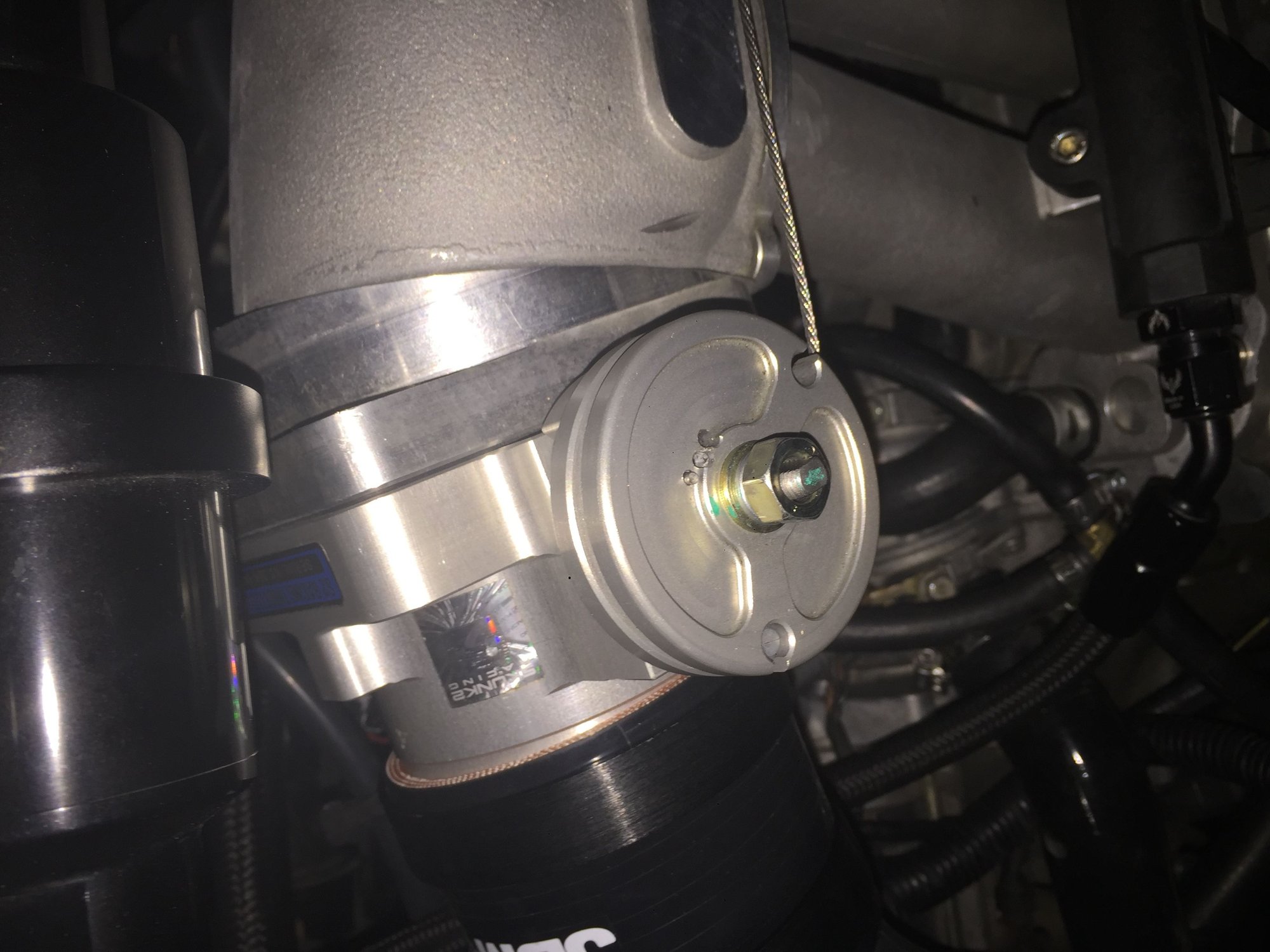

It's a common problem with the 70mm skunk2 TB. The spring tension on the pulley isn't strong enough to close the throttle plate under vacuum.
To fix it, take the pulley off, drill another hole a few mm over and re-install. Mine has 3 holes. The top hole in the picture is the original. The middle one was actually enough to fix it, but I drilled another just to be extra sure. So my pulley spring is in the bottom hole in this picture.
