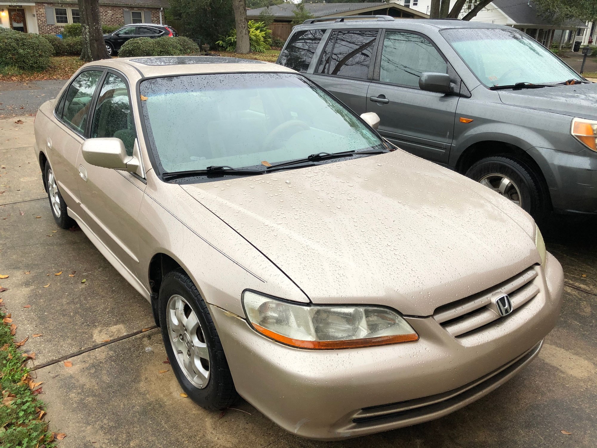

I had a timing belt change and now the pulleys are misaligned. The power steering and alternator pulleys are the correct distance apart. But both are not in line with the crankshaft pulley which I believe is also called the drive shaft pulley. It appears that the crankshaft pulley is moved farther toward the engine and away from the tire than it should be. This is causing a terrible squeaking sound which I hope is just the sides of the belts rubbing against the pulley guides. But how is this possible? When putting the crankshaft pulley back on how is it possible to put in on misaligned?
Edit 1: 2002 Honda Accord Sedan EX four-cylinder VTEC (F23A1) - everything stock and economical aftermarket (i.e. Duralast etc)

2002 Honda Accord Sedan EX four-cylinder VTEC (F23A1) - everything stock and economical aftermarket (i.e. Duralast etc).
but I don’t understand how it’s possible in any model accord to install a crankshaft pulley misaligned with the accessory pulleys.
