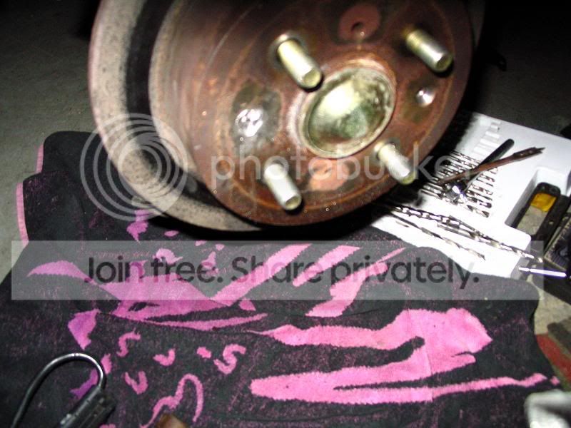

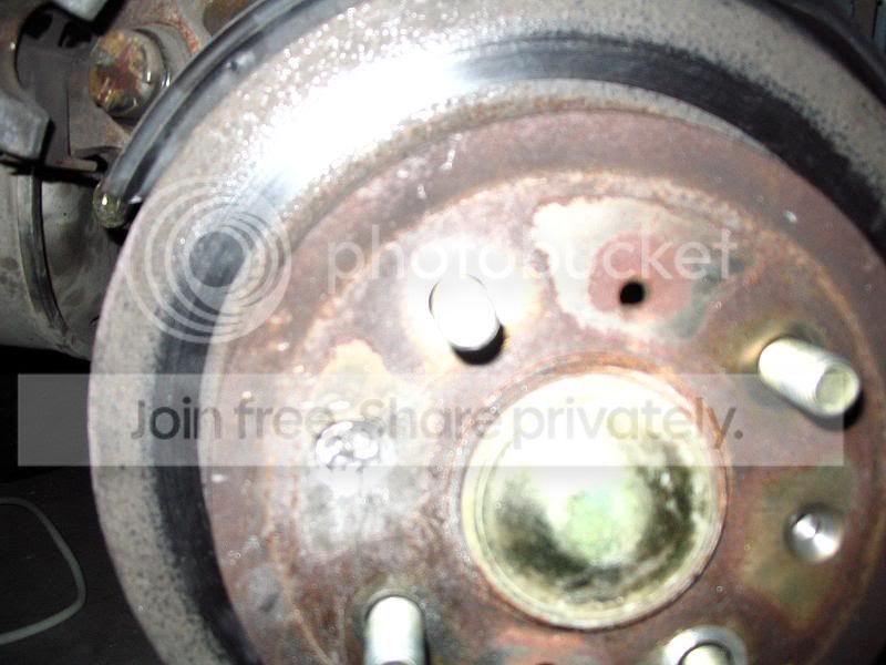

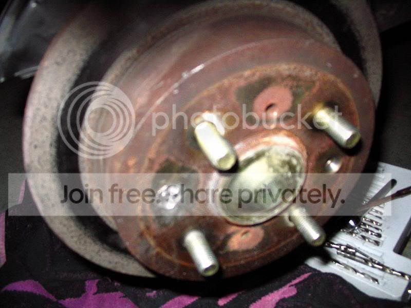

here are the pictures if anyone in the MD/VA area can help me out i will give money for gas plus a 30 pack of cold beer! please....anyone. I dont mean to beg, and i know this is the last time i touch the brakes at all!

See the other two holes? They are threaded.... use two 6x1.0 mm bolts and thread them in evenly (turn one bolt a few turns, then the other) and see if you can pop the rotor off the hub that way. The screw head may be weakened enough that will do it - dont jam them in there so hard that you hurt the hub though.

are you sure its threaded? also is there a drill bit that is strong enough to drill through this metal? the thing is the screw extractor got stuck in the screw and it is very tough metal. do you know of any drill that is strong enough to do that? or do you know of anyway i could cut around the screw hole? so the only thing left is that screw? thanks for your advice!

<TABLE WIDTH="90%" CELLSPACING=0 CELLPADDING=0 ALIGN=CENTER><TR><TD>Quote, originally posted by desipiE &raquo;</TD></TR><TR><TD CLASS="quote">are you sure its threaded? </TD></TR></TABLE>
Yes I'm sure. Thats how I always pull stuck rotors off..... pounding on them with a hammer gives me a ffing headache. M6x1.0mm bolt.

I assume you have a new rotor, so get an angle grinder in there and go to town.
Grind it down so the head of the screw is no longer holding the rotor.
Get bolts that fit the other open holes in the rotor and alternate tightening each one until the rotor comes off.
You may want to get a decent set of drill bits too, the bits featured in your pic look kinda shady-
good luck

Yeah, expecially for drilling out bolts and bolt extractors. They are usually hardened metal (but they're so god damn brittle!). If you're set on trying to drill that son-of-a-bitch out go to someplace like Sears and buy a bit ment for drilling out hard metal.
Go slow with a lot of pressure and metal chips will just start to come off, keep oiling the bit to keep it from getting too hot and ruining it.
My friend and I had to drill out the studs on my old cat so I could reuse it (poor as fawk at the time). We ended up using an air grinder, angle grinder, and drill press to get it back to working condition.
