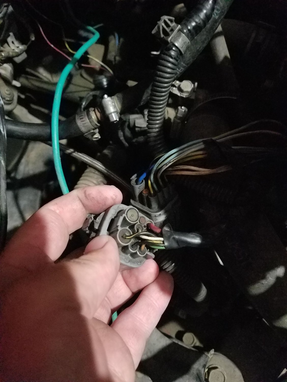

Might have found another issue pointing back to the wire harness. Dizzy is a 9 wire (in the background, 99-00 Civic Si/96-01 Integra) but the wire harness is a 7 wire (in my hand).
