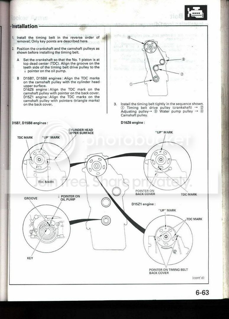

It seem likely that you may have made a cam timing error when you replaced the timing belt.

cam is one tooth retarded.

I won't drive it......have whoever did the work fix it.......and read this........
Lower right for the Z1, it has its own special timing marks......
