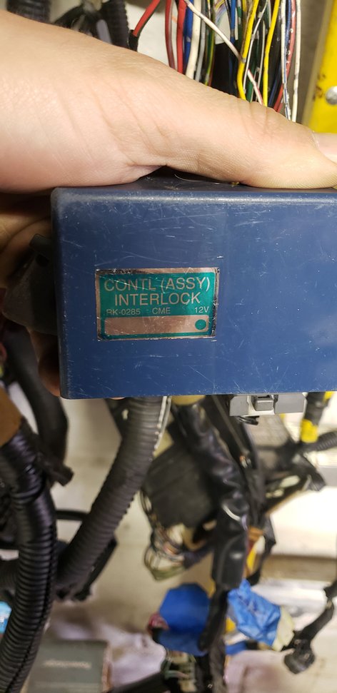

Default Re: Keyless entry removal
Originally Posted by hondamark35
oh, I see. you should be able to "dumb" down the wiring pretty well then. I'm pretty sure switched power to the ECU and fuel pump via the main relay and a starter cut relay from the ignition key should allow you to start it up.
any idea what these are and can i remove them?
