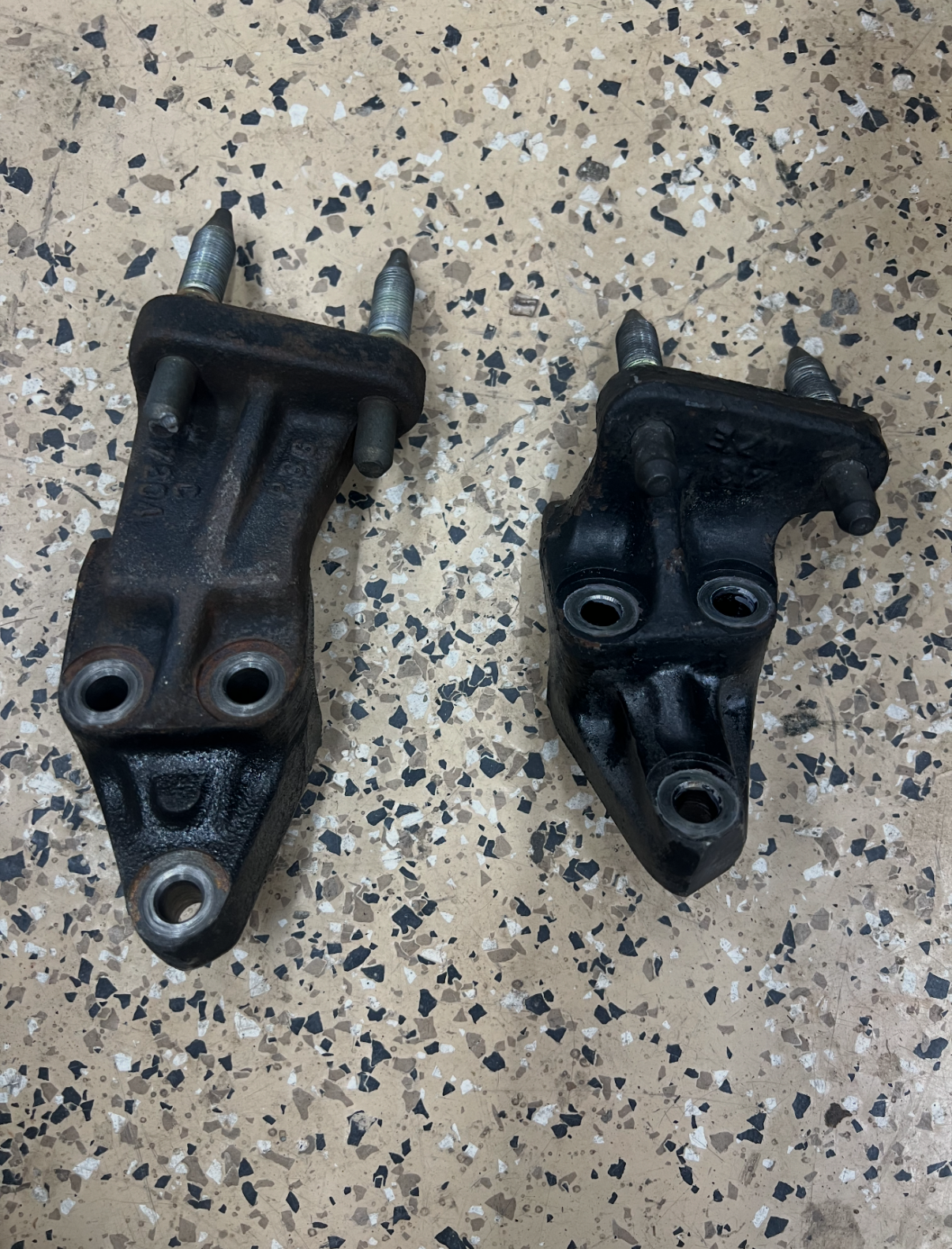

Hmm. Agree with JRCivic1. Make sure you have the CRV bracket and not one of the other brackets.
I had the the opportunity to document the difference in December when I pulled the B20Z2 for rebuild and replaced it with a JDM B20B. Knew it would come in handy sooner or later:

Default Re: Issue with engine sitting level in ej1
Other way around, I believe.
When I swapped from a D16Y7 to a USDM B20Z2 however many years ago it was, I had to acquire no mount brackets.
The taller one in the pic came off of my jdm B20B that I dropped in recently. The shorter one came off of my B20Z2 that came out.
OP’s car is a 95, so some brackets and stuff are different - in fact they are the same as Integra so the mount situation is even more straightforward… but I would look to see if that engine has the tall mount bracket before I looked at anything else.

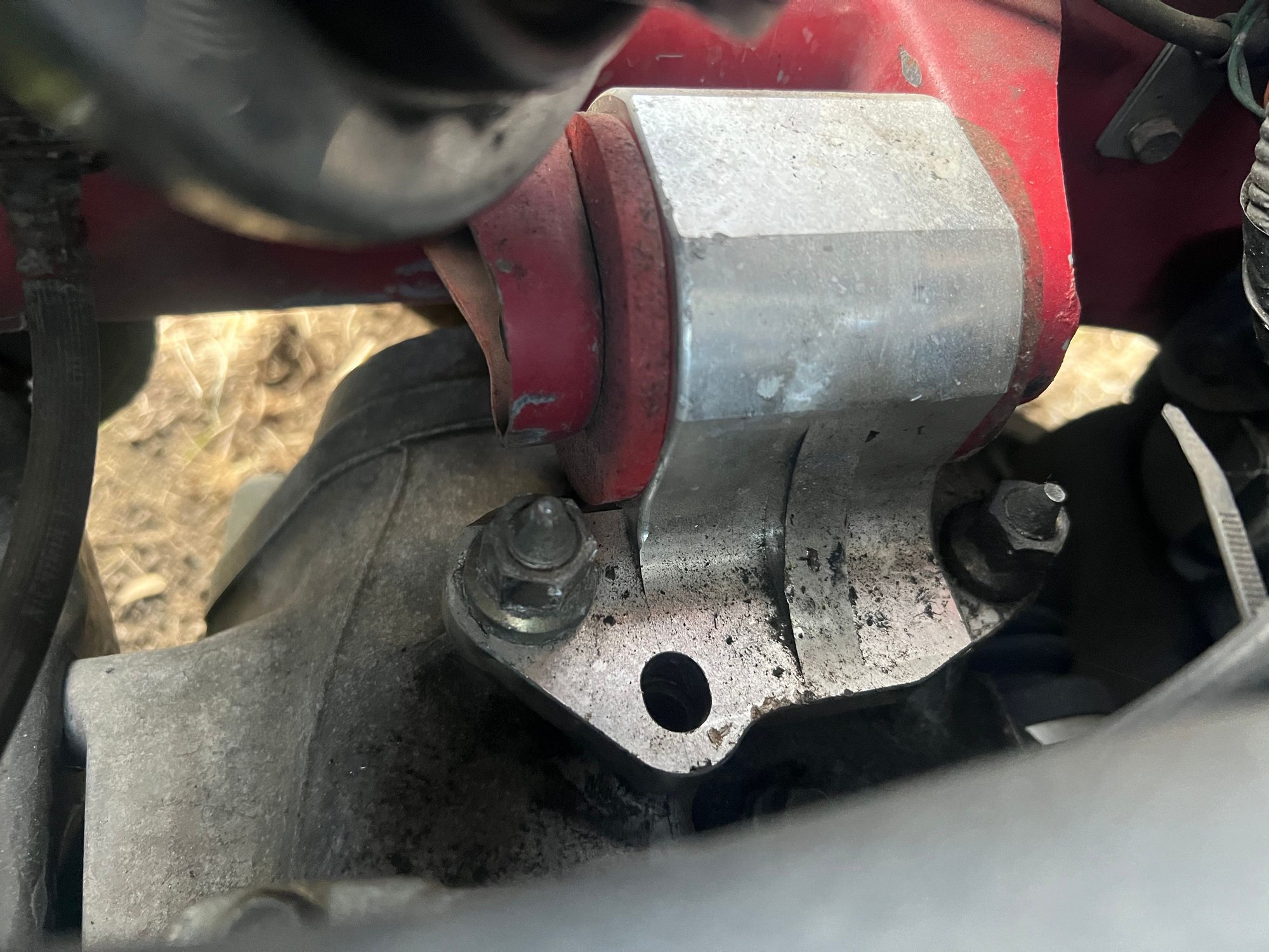

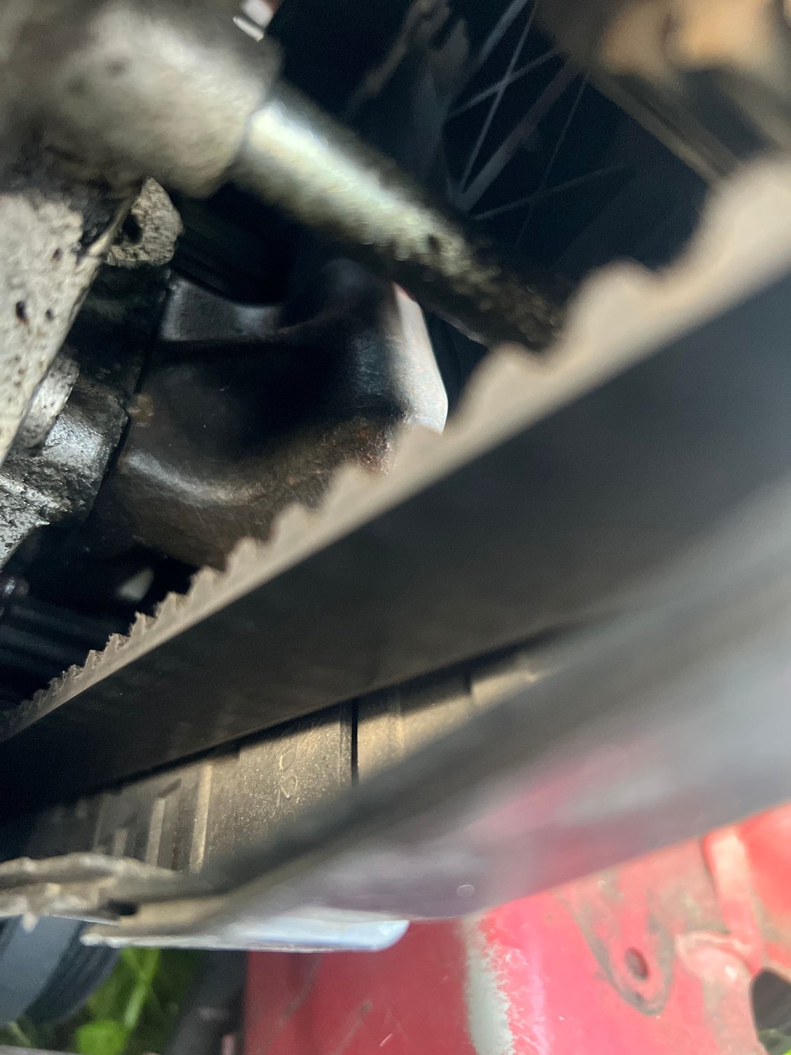

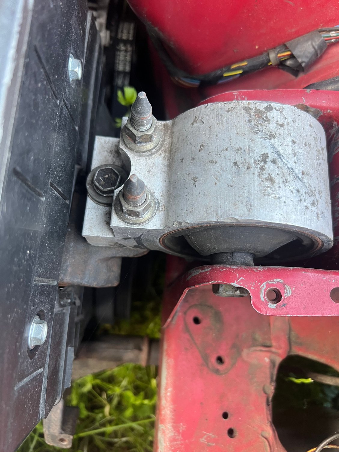

Originally Posted by JRCivic1
Your problem will NOT be the rear "T" bracket... it is almost certainly the Left side engine bracket... take a close up picture of this bracket just under the driver's side engine mount and post it here. We can confirm or dispute your assessment of the bracket being correct.
Here are some pics of the mounts

Old Jun 17, 2025 | 08:35 PM
JRCivic1's Avatar
10 Year Member
Community Builder
Active Streak: 60 Days
Joined: Jan 2013
Posts: 10,086
Likes: 1,251
Your driver's side mount is an OEM one... the fact that you do not have a complete set of matching mounts may be the issue. Remember that every brand of mounts may place the power-train within the engine bay in a slightly different place... when you start mix-matching differing brand mounts, the combination will likely create the problem that perplexes you. I suggest you purchase a complete replacement set of mounts... and HASPORT would be a good choice.
