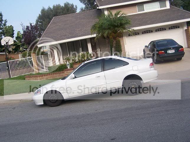

id like to know also... i started putting in my stocks and i did the rear first... its like a monster truck so i may have put the front springs in the rear...

well i did mine wrong and ir ended up looking liek this...
so the front springs at the bottom curve inward alittle bit, thats the only difference i remember when i looked at em... please spare urself the embarassment

Default Re: (Rubixcu7)
LMAO. Thats too funny.

holy cow. hows the ride feel?

thats crazy looking is it bumpy

turns feel way gay, i need to fix it obviously but it took forever to get em in...
damnit
please dont make my mistake

I cant believe you left it that way! How could you not realize you mistake as soon as it started going back together? I thought you did it just for the picture. Classic.

<TABLE WIDTH="90%" CELLSPACING=0 CELLPADDING=0 ALIGN=CENTER><TR><TD>Quote, originally posted by Rubixcu7 &raquo;</TD></TR><TR><TD CLASS="quote">well i did mine wrong and ir ended up looking liek this...
so the front springs at the bottom curve inward alittle bit, thats the only difference i remember when i looked at em... please spare urself the embarassment</TD></TR></TABLE>
LMAO... been there done that. It was a learning experience.

Geez, I think I'd **** myself laughing if I saw that monster driving down the street. How could you possibly do that???

^^Actually, the more I see that pic, the cooler it looks. People probably think you have some crazy hydraulic setup.

LOL, you could put big racing slicks in the back for the full effect! ROFL
You are a brave man posting that pic... to you!

with all the weight on the front tires... i bet you traction is much better.

yea but in a turn the back end wants to go out.. anyway... a buddy and i fixed it tonight... took 5 hours... and it was horridly embarassing to drive that car that way... and i had no rear view mirror... and the headlights here about 5 ft infron of the car...
