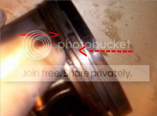

i had super low compersion in my motor going from 4 -1 120, 120, 100, 220. so i figured rings i took the motor apart found the valves are all good, and the cylinder walls all look perfect. so i pulled the pistons out while pulling them i notice the pieces of piston falling in my hand.....YAY
here is one of the 3 cracked pistons all of them looking simaliar

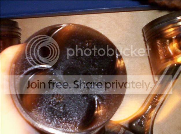

here is the top of the same piston as follwed they all look the same

More likely than not it was caused by detonation. You might want to put a knock sensor on your motor or lower your compression ratio or at least not advance your timing so far.
