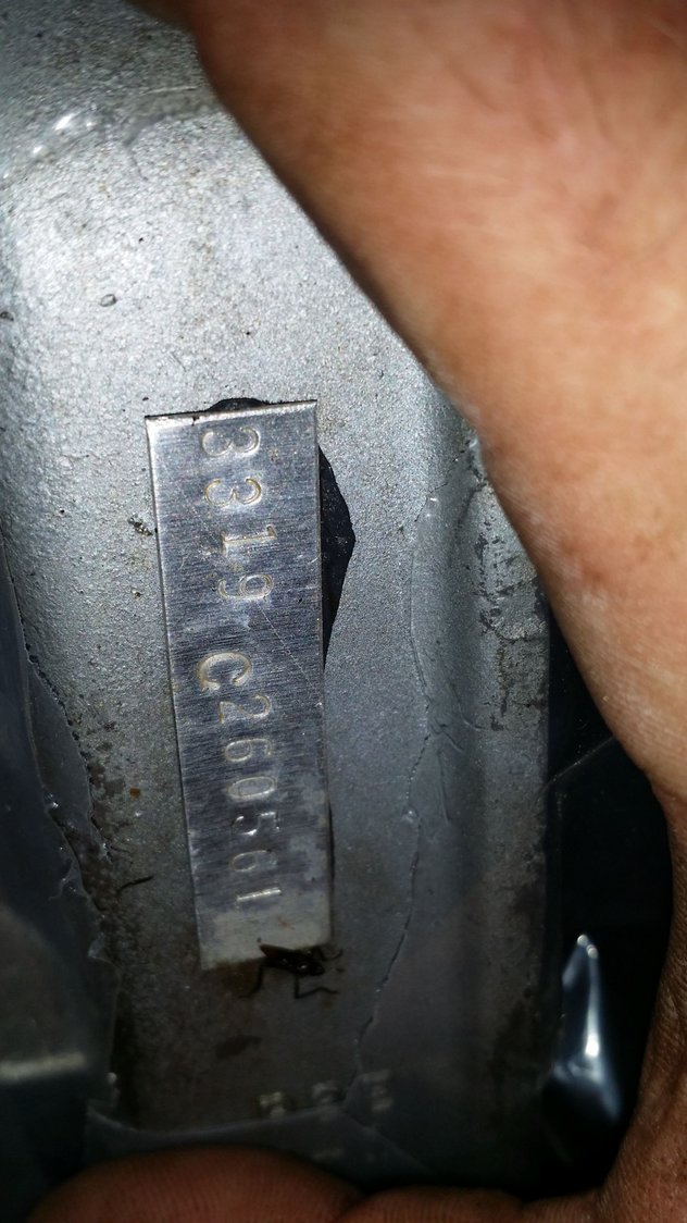

I know absolutely nothing about Honda cars. I recently came into possession of a rebuilt engine with 200 mi on it. How do I identify the motor so I can determine it's value?
There is a small plate attached to the rear of the block near the transmission mounting point.with the numbers 3319 C 260561 stamped on it, but I have no idea what this means. Is this an engine number, or is the actual number somewhere else?
Any help is appreciated.
Notice small strip plate on lower left of block
Strip is attached with some form of adhesive.

There will be a stamp on the front of the engine. That stamp represents an engine code. That engine code will determine what engine you have. Type that engine code into google and it will give you all the information you will need about said engine

By the looks of what im seeing from the picture its more than likely a D15B7. As stated it will be in the front of the block, bottom left were the transmission bolts up to. Its under the water outlet for the head about 5".
