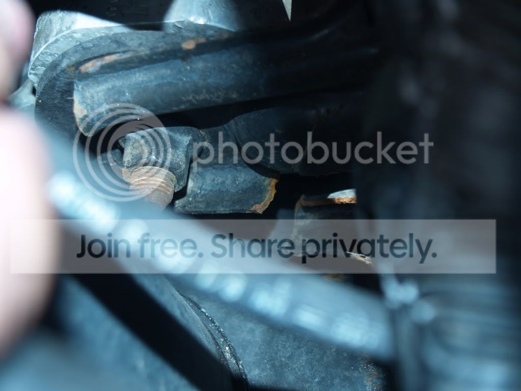

i have a 97 coupe, and the other day i noticed the motor jerk back when decelerating. I did a visual inspection and noticed that the bracket that the rear motor mount goes in is broken. the motor mount is fine its just the bracket where the bolt goes in.
a friend said i needed to replace the whole subframe? true? do you think i can get it welded in the meantime? I ask because its my daily driver and i cant have it out of commission for long

Can you get a pic?? Try shining a flashlight down there and using a camera phone or something and snapping a pic... It'll be a lot easier to help you out if you do...
If it is the 2 metal tabs that stick up, that go on each side of the bracket, that are broken, then yes, they have to be welded... If it is the bracket itself, then it can be replaced

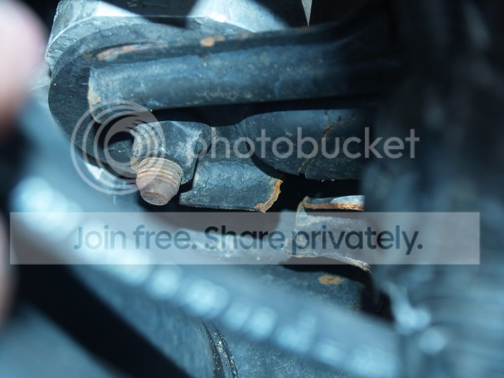

ok here are the pics.. they are both of the left side... the right side doesnt seem to be cracked or anything

Is that theeeeee..... Drivers side??
It's a bit out of shape, but a shop can toss the car in the air, unbolt that mount, weld the tab back in place, and bolt the mount back up...
Might also want to check your other mounts as well... I've only seen that happen on cars that are driven REALLY hard... I mean... Downshifting from 4th to 2nd and stuff... a lot! lol
So your other mounts could be bad, letting the engine move enough to tear the steel mount bracket... That's pretty tough to do...

thats the passenger side... thats the thing tho lol, its my daily driver and i don't beat on it at all. i haven't hit vtec in it for weeks! lol. but thanks for your help, you've answered my question. I don't need a sub frame thanks bro

Hmm... Im too lazy to walk down 3 stories of stairs and pop my hood... lol
But if thats from the pass side, then i guess the mount itself (the silver colored part of it) would be the part mounted on the chassis... Sooo.... That could very well be an L bracket, which is a replaceable part you could find at a junk yard... It would bolt to the motor, and then the mount would bolt to the car, and then a bolt would attach the mount to the bracket...
It's been awhile... But that could be the case... Hopefully someone else can chime in and back me up or correct me...

hmm that makes alot of sense. all i have to see is if the broken part is atached to the motor, and that would be it right? im going to go check now.

Do you have a B series swap? If so then yep, thats what I was thinking it was...

yup its a b series. after cheking it out closely, I confimed that it was actually that part. so i went over my cousins house and he had three of them layin around the shed!! thanks alot for your help phre0nburn
