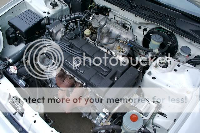

I cut my wires, and ran them through a whole in the bay, then soldered and heat shrunk them once through the fender wall. You can remove all the black wire protectors, and seperate the headlight harnesses, then pull them through the firewall and run them out through the holes in the doors inside the cabin. You have to extend the passenger side though I believe, driver side is easiest. Just do it the good way and extend all the wires, do both headlight harnesses, and it should look like this.....
