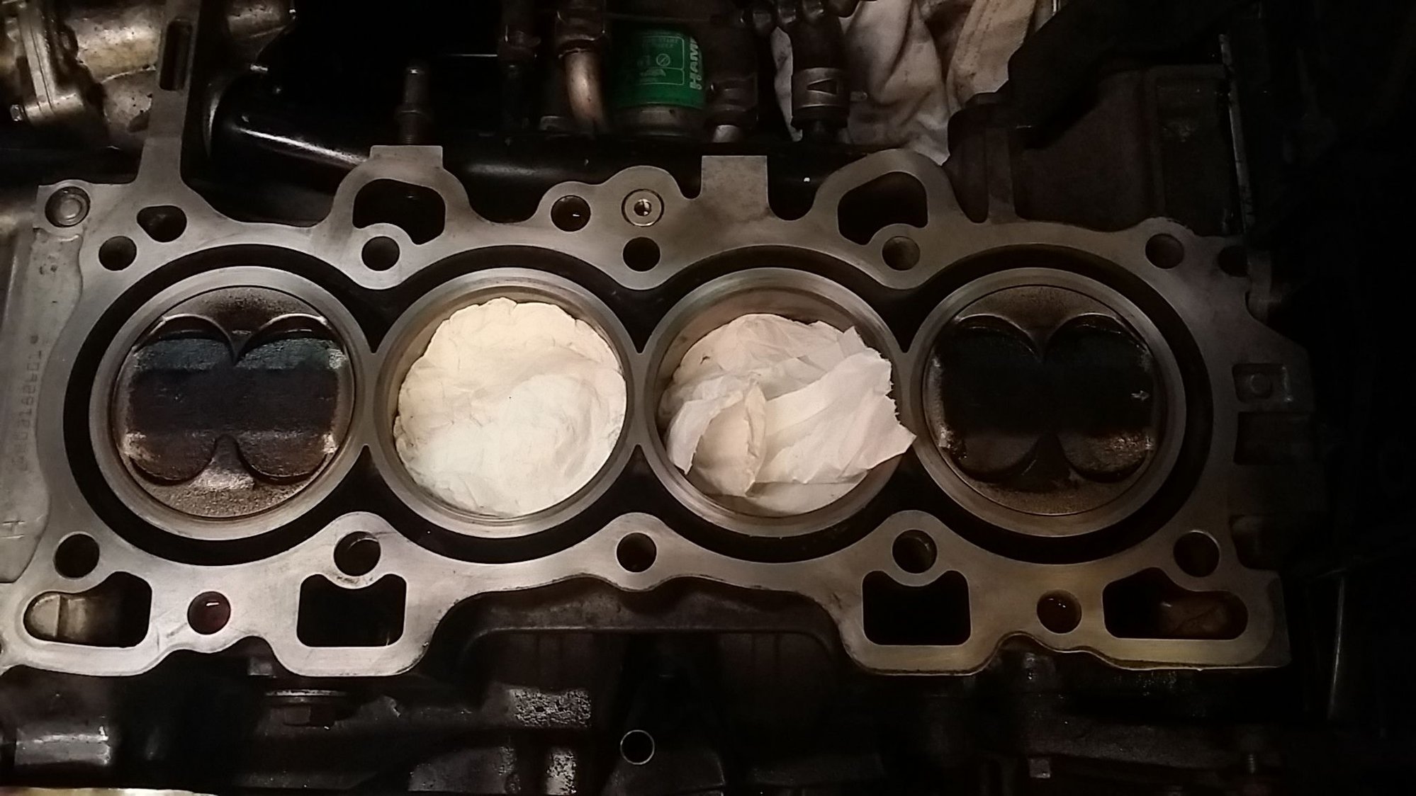

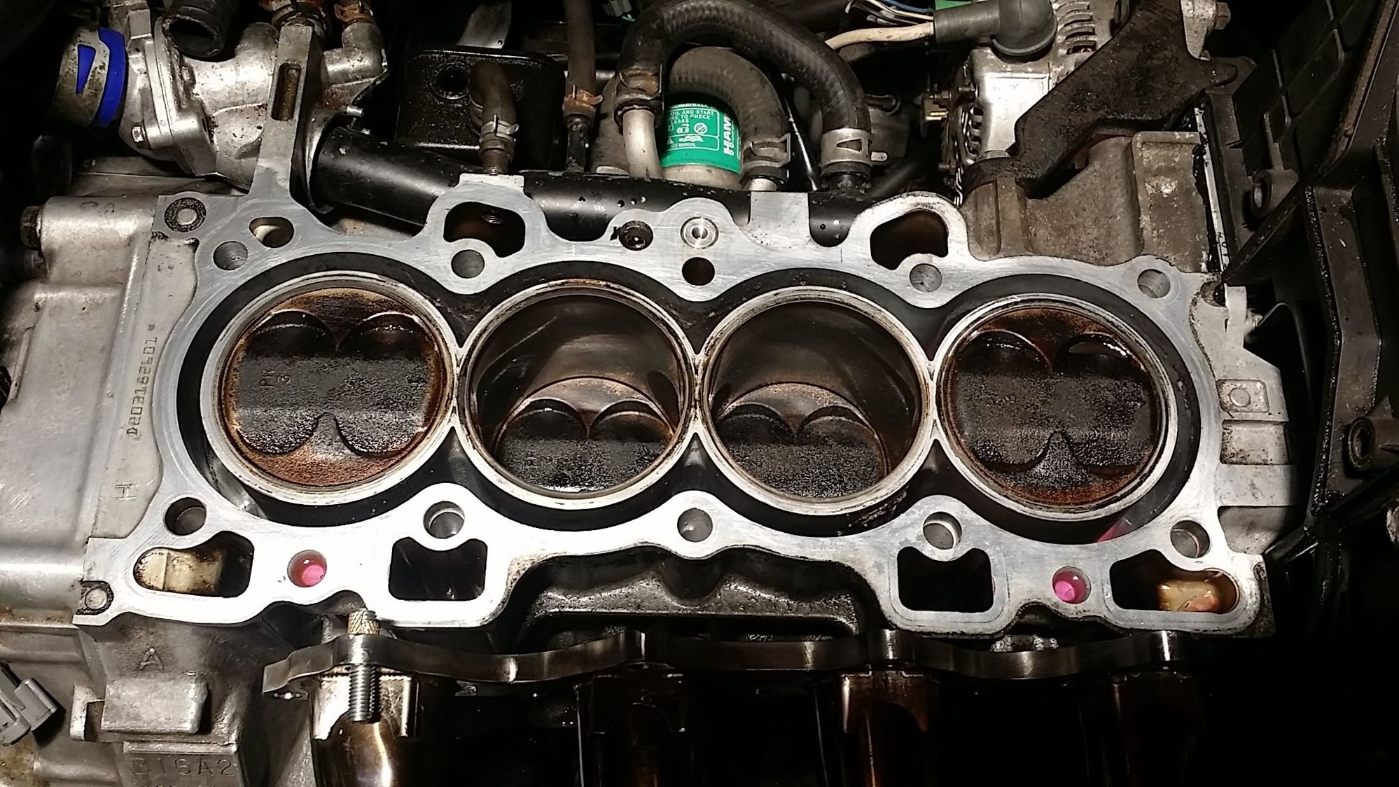

i had bubbles and presure in the rad.
no oil or coolant mixing and no white smoke.
removed the head
i think it leaked at the 3 cylinder into the coolant chamber
what do you guys think?
did i cleaned the block surface good?
in the front left corner there is some dirt that would come of.
it leaked oil before in that corner
i steelbrushed it and sanded it a little but i dont want low spots
the head is millend today

Is the block surface flat? '
You need a straight edge and feeler gauges to check this. Something like in the link below.
Tricks of the Trade: Cylinder Head Distortion Check - Import Tuner Magazine

i didnt checked that yet.
do you see something wrong on the clean up picture?
i did have the head surfaced but it wasnt warped .
thnx

Did you do a compression test or a leak down?
Pressure and bubbles in the rad doesn't mean you have a bad head gasket.

no didnt do a leak down or compresion test.
there could be 2 ways air getting into the coolant.
changed the thermostat,rad and hoses and bleed it for 2 hours.
but stil huge bubbles comming out of the rad.
thnx for you reply

When the head overheats it's not just the gasket that goes bad, the head is permanently warped. It either needs to be put in an oven at 500 for some time in between two straight pieces of metal or you need to resurface it. Simply replacing the gasket and cleaning up the surface won't accomplish anything.
You also need to check the block as the above poster said to determine if the block got warped which is more rare but not unheard of.
thnx for you reply
The times I've had blown head gaskets there's liquid on at least one cylinder, that's how I've know I had a bad gasket. The surface looks great after you cleaned it so you did a great job at that.
Last gasket I did was a single cam with the oem "cardboard" gasket, all I did was clean it the best I could and slapped it back together. For me, as long as it doesn't over heat too bad the head should not be warped. I've done two sohc like this and they are both running strong since, and its been a couple of years.
Also, you CANNOT check for straightness with a regular metal ruler.

thnx guys.
i did surfaced the head.
but i didnt surfaced the block bottom
last night i replaced the gasket.
today or tomorow im going to test it

How did you clean the surface? Sand paper? No,no!It should be as smooth as glass with no roughness to it. So should the head, other wise the headgasket will leak again.

the surface i cleaned with brake cleaner and clothing.
i sanded it 2 or 3 strokes in the right front corner because it was dirty there alot.
i coulnd hurt sanding it 2 a 3 strokes there
you should look at the bevore and afther picture,the dirt is stil there.

As long as the surface is smooth. Despite the moronic opinion that the head gaskets only leak when there is warpage,that is rarely the case.
MLS gaskets conform well to slight variations in head and block surfaces,however the coating on the gasket must remain intact. This coating(looks like black/blue paint) is a major part of the headgaskets sealing properties.
MLS gaskets rarely break,instead the coating erodes and comes off over time or in the event of overheating,typically at the cylinder sealing rings.
But if the surfaces of the block and head are rough,they will prematurley damage the HG during contraction and expansion.
Make sure the surface is a smooth as possible.

You really need to straight edge the block. Dont know how many clowns over here dont do that end up with the same issue. Dont forget to check the head as well with the straight edge. Looks like it was leaking into both cyl 2 and 3. A good indication is how clean the pistons are. Also, I personally do not reuse headbolts.

Ive used a 2x4 and some sand paper. Maybe 200 grit and stroke even across the block and you can see if there is a low spot or hight spot.
Not on heads tho. Those go to the machine shop
Its not the right way to do it but if you dont want to drop 150 bucks for a precision flat bar then itll work
