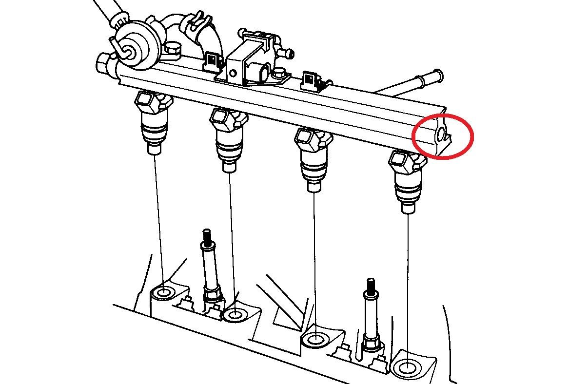

Hey guys, was wondering if anybody knew how to take the plug out of the end of a d16y8 fuel rail? One end has the banjo fitting with 12x1.25 threads, got that out easy. It's the other end i'm stumped on. It's not solid metal but I can't see any kind of snap ring either. I'm fairly certain that I could force it out with some drill bits and such, but thought i'd pause and ask some others first.
Here's what i'm talking about.

This is as good a pic I can get of it.

It is pressed into the fuel rail during manufacturing. Why are you trying to remove it ?

So it's pressed un huh? ok. I want to run a -6AN fitting in there as it's on the driver's side. Fuel would get to all the injectors and then go out the other side via -6AN to external fpr and return excess to the tank.
