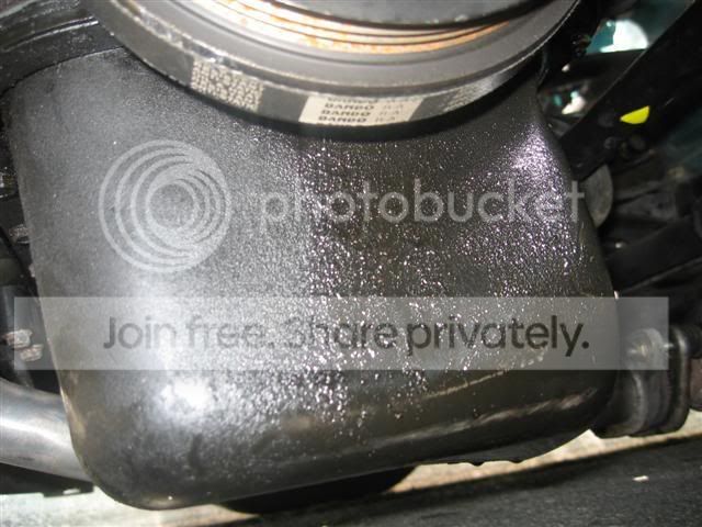

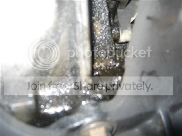

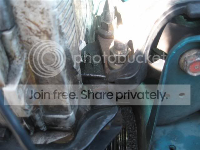

i think both of them are leaking. cam seal and the front main seal.
Old Apr 22, 2007 | 01:13 PM
riceburner700's Avatar
Posts: 559
From: loveland co, United States
Default Re: (SLOW_TEAL_HATCH)
that looks just like the cam seal because it runs down the front side of the block by the oil pump. try spraying all the old oil of with some carb cleaner and rags. take it for a test drive and see were its leaking.
Old Apr 22, 2007 | 10:08 PM
TheTealHatch's Avatar
Posts: 1,999
From: no where
Default Re: (riceburner700)
yes it was the cam seal. friend said the cam seal was basically pushed out of its place cause of the motor being in an accident
