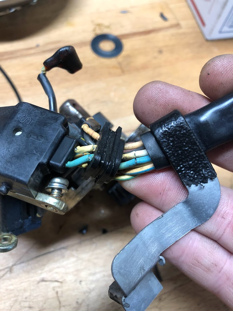

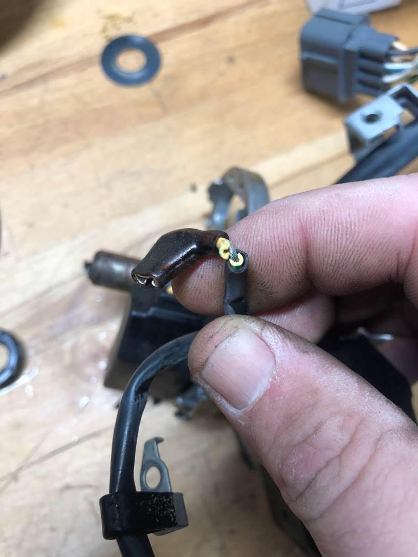

About 3 years ago before doing my GSR swap, I got stranded in a parking lot after a coil went bad. To prevent that from happening again...I know some people just replace the coil every so often. The other way might be to use an external coil. I won't spend a $1000 on a coil on plug setup, so I'm looking at the VMS or MSD coil and the disributor cap that goes with it. About $100.
Anybody have experience with these products?
Thanks....thoughts, opinions?

I hear you, just offering my perspective and experience. I don't personally think the MSD is up to the task of living on a street car. Again, just my personal experience. You have yours and that's valid too.
Coils & ignitors have always been a pinch point on these cars. The OEM ones generally last a really long time. When I was wrenching, I would keep a brand new one of each in my box. If a no-spark car came in, I'd just swap them in one at a time, send the car on its way when it fired up, and put the next new one in my box after the customer was already gone. It was a continuous cycle. I still keep spares to this day.
The new issue for me has been finding a distributor where the wiring insulation from the sensors isn't all deteriorated and crumbly. Can't really rewire the mag sensors since they are potted:

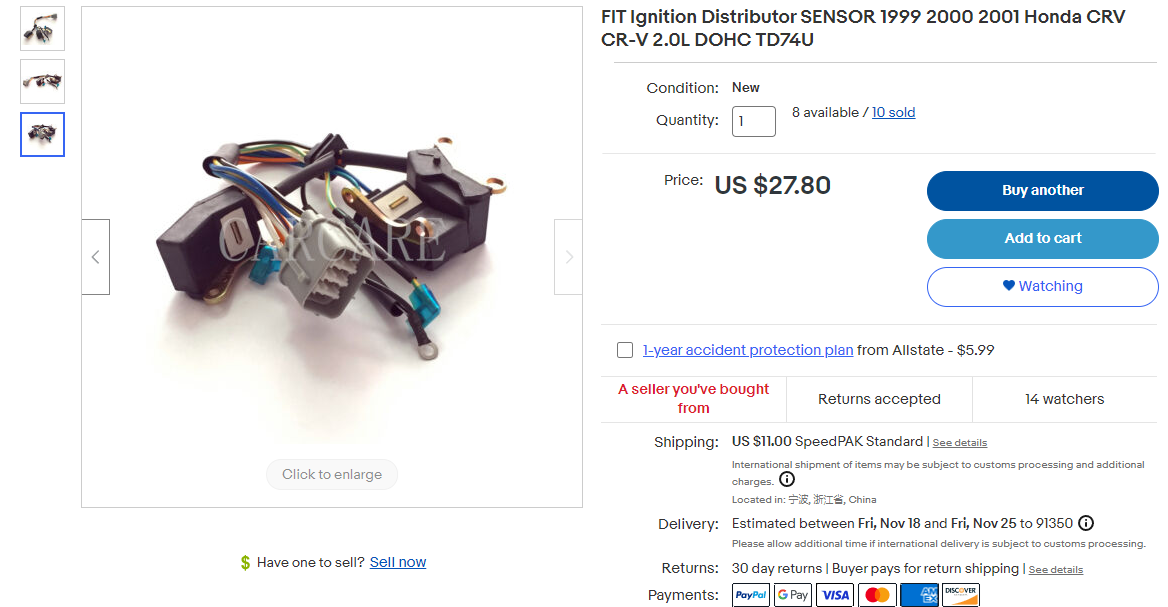

So I'm going to try this set of replacement sensors in a spare distributor and see how it goes, just for the sake of the experiment. If they work fine, I've saved a distributor for ~$40. If they don't, it's no more of a paper weight than it is now.
FIT Ignition Distributor SENSOR 1999 2000 2001 Honda CRV CR-V 2.0L DOHC TD74U | eBay
What ecu are you running? Have you considered coil on plug? There are easy (mostly) plug & play solutions now, even for oem ecus - and four oem coils are better than one MSD or Accel.
