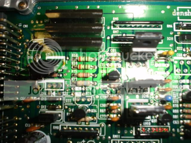

Ok guys im new so spare me if its in the wrong place or if im asking it the wrong way!!!!!
Im frustrated!!!!!!!!!!!!
HEre i go .... I have a p06 auto , i converted it to 5 speed and i installed the Vtec conversion from Xenocron!!!! Car starts up fine , drives fine , but Vtec does not ENGAGE!!!!!!
ive gone over the install like 7 times eve compared it to another ecu that had been converted and i cant fin reason y its not working!!!
PLEASE HELPPPPPP!!!!

You add the transsistor at Q26? Is it facing the right way?

I can check it out for you if you want. It is easy to overheat the board when desoldering it.
What tools did you use to de-solder and solder it? (watt, etc).

Have someone take a look at your ECU and do a continuity test on the new parts that you added.
Are there are any light green, yellow or brown spots on your board near any of the parts that you soldered on?

Since your ECU is auto...you can try desoldering one of the other Si5151 switches and replacing the NEW component that comes in our kits...in case you overheated it or for the first time in 4000 pieces sold you received a faulty component.
If that doesnt fix your problem, then you might need to order another Q26 transistor...and try replacing that next.
I know no one ever thinks that THEY could have done anything wrong when playing with electrical components...but guess what, 100% of the time I am sorry to say it comes down to user inexperience. Even with the right tools, and the wrong attitude, many things can go wrong...you just have to get over yourself and figure out how to fix the problem instead of attempting to unfairly take the blame off of yourself.

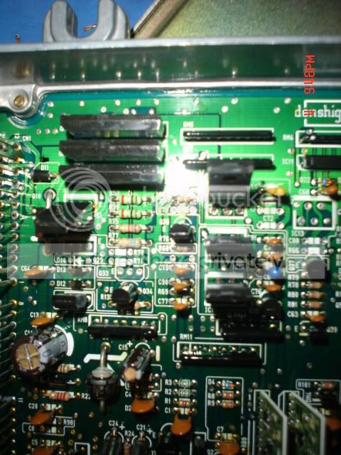

1720 kits, Q26 is a D1423
11F0 kits, Q101 is a SB1030
From your pictures you have a 1720 Board, so you should have ordered the 1720 Kit and be installing a D1423 in spot Q26
I just looked up your order in the system...you ordered an 11F0 kit and followed the wrong set of directions apparently, there is your problem
You need to order this item and install it in Q26...
http://www.xenocron.com/catalo....html

I fixed it by replacing the q26 i had recieved with a q22 from another p06 !!!
