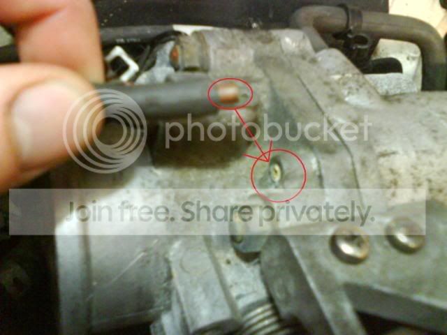

During my swap I kinda broke something on my intake. Well you guys take a loooooook...
Now what would be the easiest way to fix this?? I was thinking about trying to drill it out. What do you guys think.

The piece in the throttle body is just pressed in.Try screwing a sheetmetal or wood screw in it a couple turns.Then pull the screw head with a pair of vicegrips or pliers.You may have enough of the nipple left to press in and still have enough to hold the hose on.

You sir are a smart man! Worked like a charm. Thanks!
