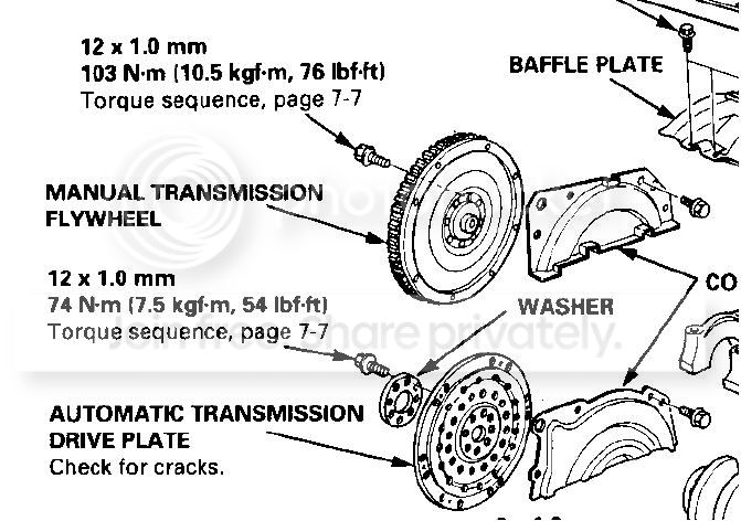

Old Jan 16, 2006 | 03:47 AM
shorto85's Avatar
Posts: 743
From: Sacramento, CA
Here is what my helms says...
Old Jan 16, 2006 | 07:44 AM
drdisco69's Avatar
Posts: 3,914
From: Charlotte, NC
It looks like Timesert doesn't have that size either. Not looking good...

update for anyone who was interested...
I found a local hardware supply shop that was able to order a 12mm x 1.0mm helicoil kit for me. it's ~$60 he said and should get here early next week
