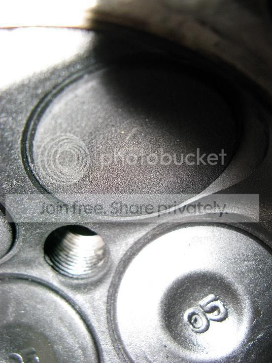

can this block be saved... pics... lots.....

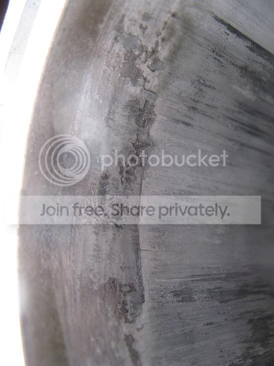

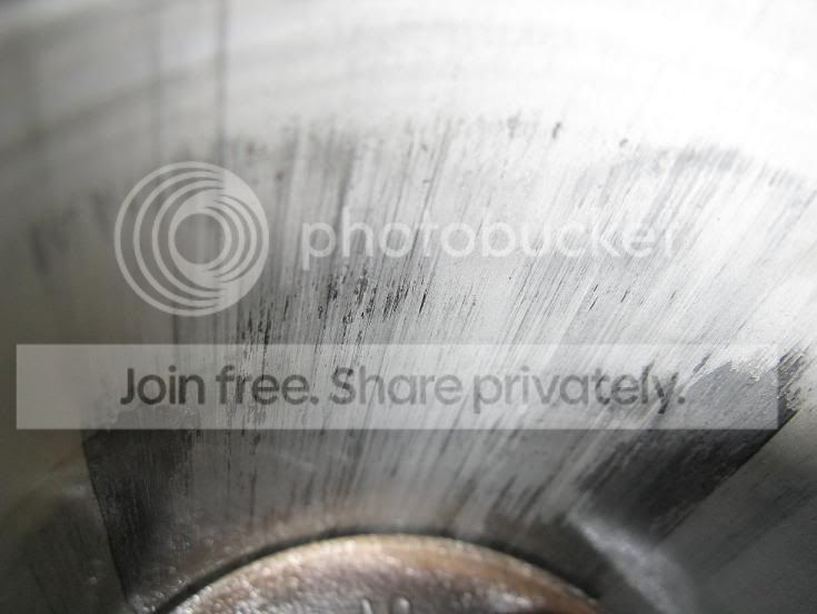

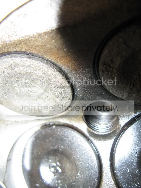

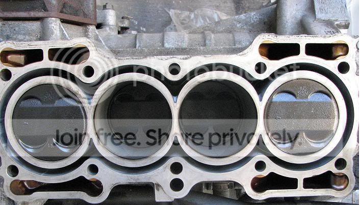

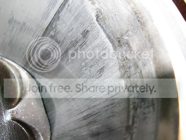

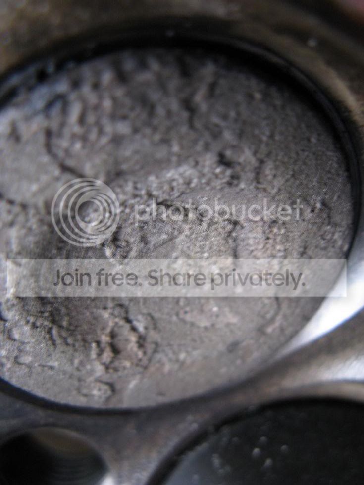

h22a4....
Old Oct 14, 2008 | 03:17 PM
mmuller's Avatar
Mad Scientist
Posts: 5,827
From: tallafizzy, FL state
Default Re: can this block be saved... pics... lots..... (racerxh00)

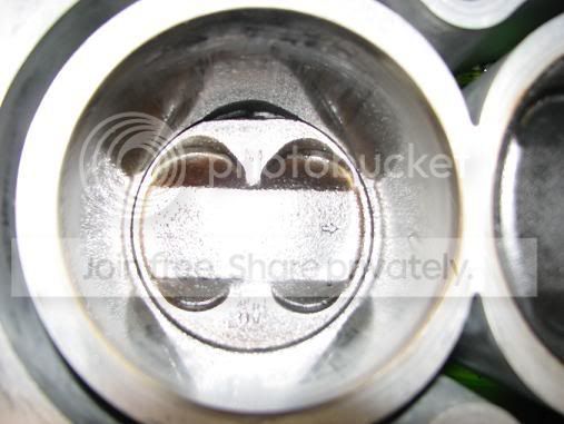

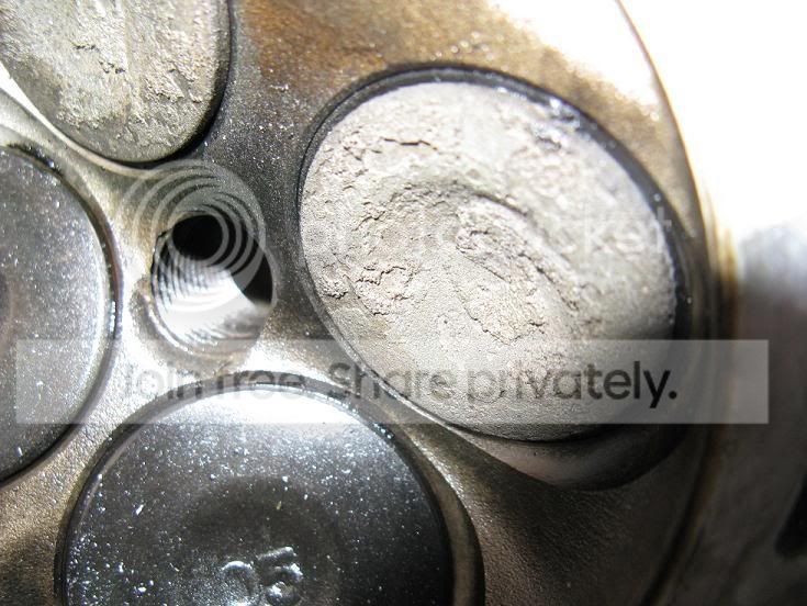

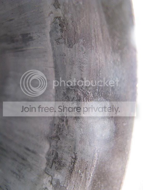

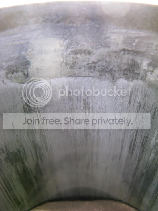

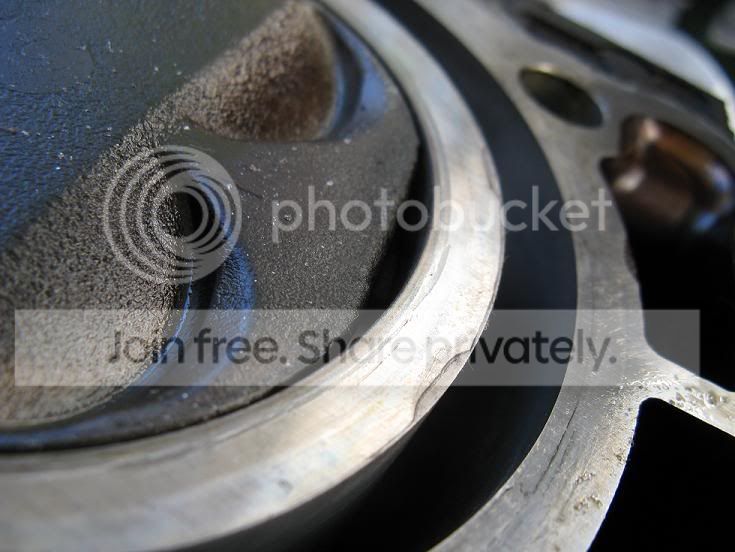

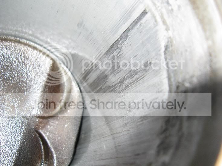

pre-ignition is a bitch
- can be saved if you bore and re coat the cylinders
Old Oct 14, 2008 | 03:18 PM
SlowReaction's Avatar
Posts: 953
From: Wa
Depends on what do you mean by saving it. What are you trying to do with it?
Old Oct 14, 2008 | 03:25 PM
racerxh00's Avatar
Joined: May 2008
Posts: 83
From: reno, nv, us
Default Re: can this block be saved... pics... lots..... (SlowReaction)
tryin to make it run...rebuild.... i dont want to discard it unless it cant be saved.
Old Oct 14, 2008 | 03:59 PM
mmuller's Avatar
Mad Scientist
Posts: 5,827
it would cost you a decent amount of money, not easy if thats what your asking, frm is about 100 a cylinder
Old Oct 15, 2008 | 05:47 PM
Lubo_25's Avatar
Posts: 875
From: hamilton, ontario, canada
if you have the budget sleeve and hone with forged pistons...
Old Oct 16, 2008 | 11:15 AM
patriot's Avatar
Posts: 902
From: Brookeville, MD
Default Re: can this block be saved... pics... lots..... (Lubo_25)
Yeah, I was going to recommend sleeving. Then some Endyn pistons
Old Oct 16, 2008 | 03:58 PM
CerealKiller's Avatar
Posts: 1,319
From: Southern Cali, Estados Unidos
Default Re: can this block be saved... pics... lots..... (mmuller)
<TABLE WIDTH="90%" CELLSPACING=0 CELLPADDING=0 ALIGN=CENTER><TR><TD>Quote, originally posted by mmuller &raquo;</TD></TR><TR><TD CLASS="quote">it would cost you a decent amount of money, not easy if thats what your asking, frm is about 100 a cylinder</TD></TR></TABLE>
Damn!!!!!, GE only charges $180 for the whole block. That is IF it is still good enough.
Old Oct 16, 2008 | 06:14 PM
patriot's Avatar
Posts: 902
Default Re: can this block be saved... pics... lots..... (CerealKiller)
180 for the bore and coat? seems oddly cheap to me
Old Oct 17, 2008 | 07:30 AM
Golden Eagle's Avatar
Posts: 5,031
From: San Dimas, CA
Default Re: can this block be saved... pics... lots..... (patriot)
that block is beyond bore and hone and needs to be sleeved. i do not suggest trying to recoat the block with some frm spray its not Worth it.
