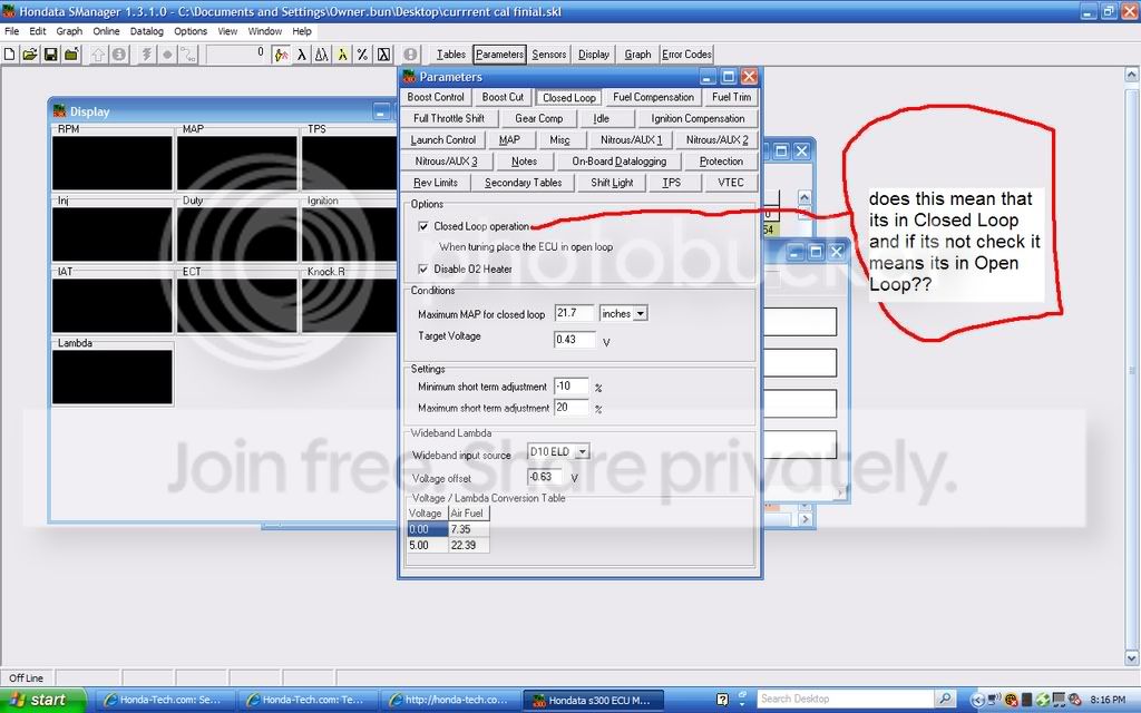

so when i making changes to to my table i have to have the closed loop check or uncheck???
thanks again H-T im learning so much im like a kid in the candy shop right now lol

If the checkbox is checked, then closed-loop feedback is turned on. Unchecked means it is in open-loop.
Disable the oxygen sensor heater if the oxygen sensor is removed. Leave it enabled if the narrowband oxygen sensor is still in the exhaust stream.

so when i make changes to the table do i leave it check or uncheck? and i have the o2 sensor still in so what should i do disable it or turn it back on?

Uncheck the first box while tuning the base map.
Verify the second box is checked if the narrowband oxygen sensor is still in the exhaust. If it's not checked, then put a check in it.
The fuel base map spits out a pulsewidth number and the correction factors (e.g. coolant temp, air temp, oxygen sensor) modify the base number. The concept is simple. You don't want the oxygen sensor to affect the fuel trim while tuning the base map because it will always try to pull it back to the preset voltage. If you take it out of the equation, then you get better representation of the fuel base map.

ok ill will try that, ill uncheck the first box,(close loop opp) and i still have my 02 sensor in my exhaust so ill leave that box checked.
