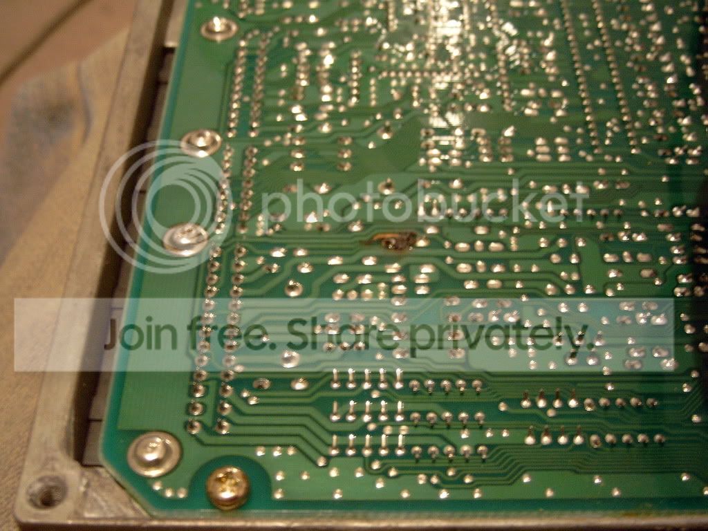

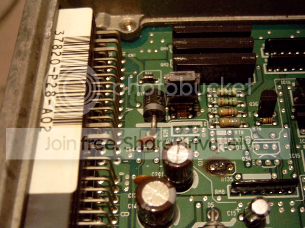

the pics say it, Q31 or R135? and WHAT DOES IT DO?????

The transistor burnt because the two wire plugs were crossed for intake air temperature & evap.
The intake air temperature sensor on the car is probably damaged.
I have seen ecus function fine after q31 being burnt, yet I have seen them fail also.
You may need to replace the ecu with a chipped ecu.

if u get it chipped it will throw a soild ecu without Q31.
Q31 is the transistor that commonly blows up when someone plugs the Purge Control Solenoid plug into the IAT sensor.ive fixed 3 of these ecus and everyone threw a soild cel untill i replaced the part.
and fyi from the looks of the pics it blew the tracer off the board so in other words it cant be fixed.did it leave bunrt marks on the underside of the lids?and like
mtber said u dont need it!

Not sure if Q31 is the problem or if its the tracings around it, but the two ECU with burnt Q31 threw solid CEL's when J1 was connected but did NOT throw any CEL's when it was running with J1 disconnected.
Whatever the case I'm buying some Q31 pieces to re-solder into the ECU and see what happens...

btw by one of them pic of the bottom of the board it looks like u blew the tracer off the board.

Thats what I initially thought too, but I plugged the "SAME" chip into another ECU and the car started up fine and ran off the chip. No CEL or anything...
So in conclusion, I'm suspecting its Q31 or something related to it being burnt. I'll update this thread once I replace the Q31 piece and if it makes any difference.

Im having the exact same problem my engine runs a bit sluggish and my rpm idles when i rev the engine around 6000 rpms ... I opened up my ecu and come to find out transistor Q31 is burnt .... Also my ecu wont communicate with my obd2 scanner
