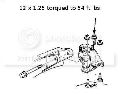

I found it and I was assuming it was B series which I guess I shouldn't have.
I was talking about this one.
heres the bolt spec
12 x 1.25 mm torqued to 54 ft lbs

Just for Del Sol on Roids reference that is a picture of a passenger side tranny mount, NOT the driver side motor mount.

Wow can't believe I missed that. Thanks for the correction.
Heres the right pic for the OP.
