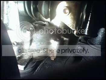

ok so i bought this LS tranny that has been sitting for maybe 6-12 months
I put it on my car, it ran great for a couple days. but then i started to see smoke on the way home yesterday.
when i pulled up into my garage, i saw a trail of transmission oil from behind.
I WAS LIKE WTF!!
jacked up the car, and saw a quarter size hole on the side of the transmission casing, right next to the shift linkage.
what could have made this happen?

taken with my picture phone.. srry for the bad quality.. but if u work on hondas you know exactly where this is.. on the rightside of the shift linkage.

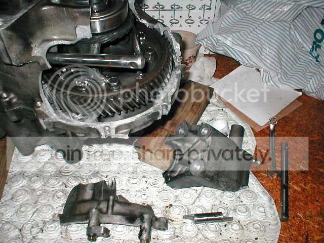

such minor damge damage......
sounds like the retaining pin for the diff cross pin broke and worked it's way out.

WHOA!!!! now thats a blown TRANNY!!
