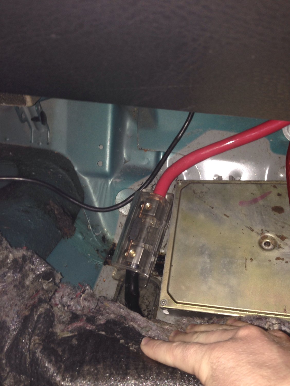

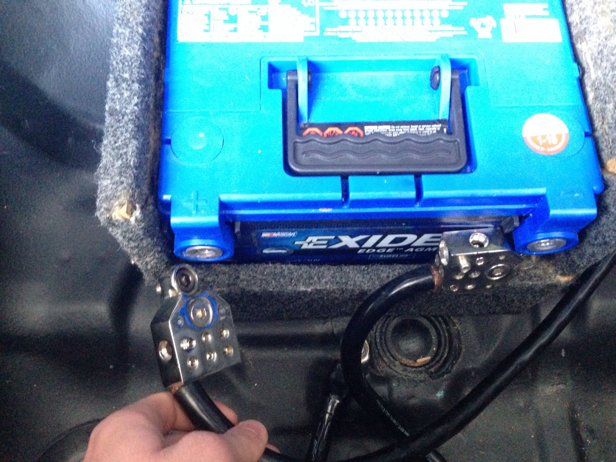

Distribution block with power cable, msd ignition,starter, white cord from fuse box.
Breaker with 4g wire
Postive and negative hook ups.

The hardware looks legit, what are the problems?

Like the power will cut out time to time and the battery dies real quick

Where is your ground?

The ground is fine its screwed into where the tire was mounted but ill be moving it soon because i will be putting the battery on the side

the most common problem i have seen in battery relocations is a bad ground. usually too much paint or corrosion on the connection.
