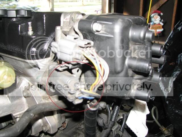

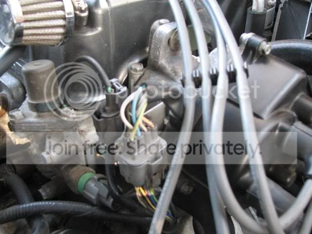

ok i have a 99 civic ex and bought a Jdm b18c engine swap for it, I know i have to use the ex harness and yes both are 0bd2, But the question is on the b18 dizzy, there is two plugs and on the ex theres on one. What needs to happen here?

i believe u can either get a b16a2 dizzy or convert from the 1 plug to a 2 plug

the 99ex has the smaller distributor plug so the 99si dizzy won't work. u need to match up the plug wire color for wire color for it to work. you should also have to rewire your alternator plug and injectors if you're using the obd1 motor in your obd2 ex car. any other questions just shoot me a pm
