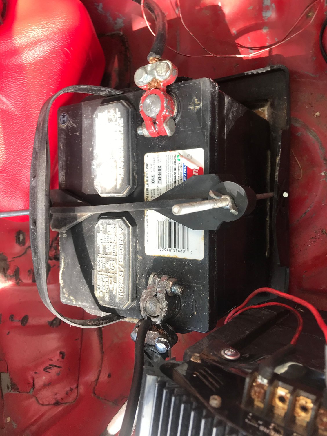

Is that a chipped p28? You could get a p30 to be proper since your converted to obd1, also your "starter clicking" would point to it not getting enough power to get it to do its job. Since the battery has been relocated, make sure your grounds are making clean bare metal contact.

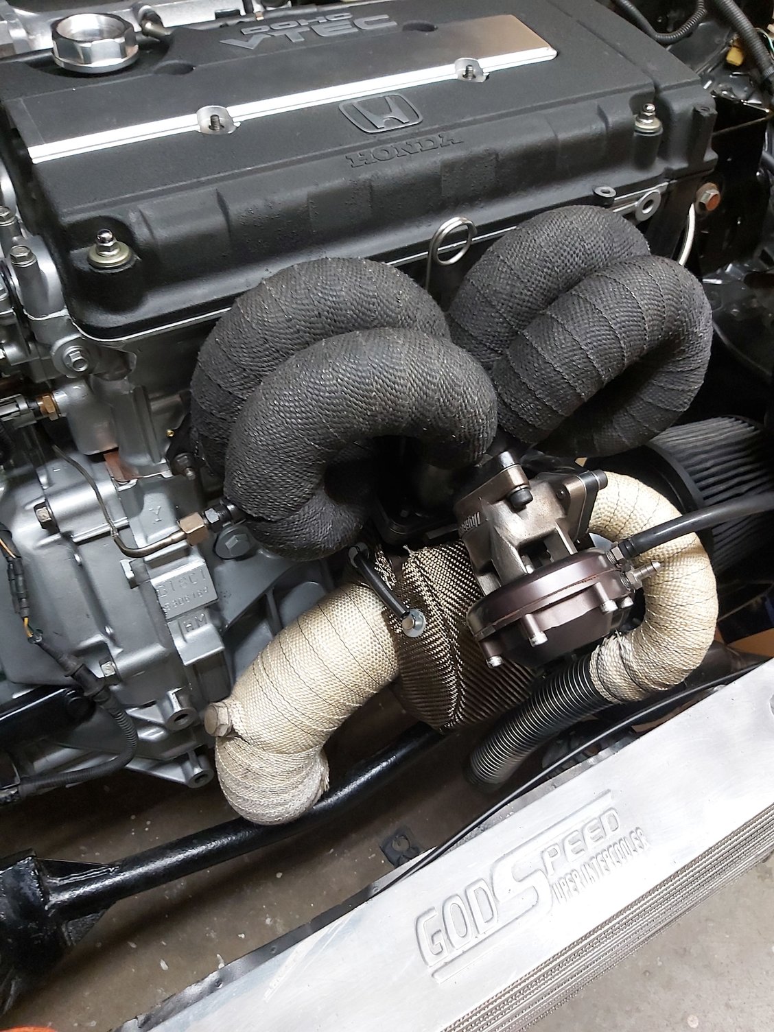

If that all checks out fine, you could do like I did and get some exhaust wrap and do the exhaust manifold and down pipe also get a turbo blanket to aid in keeping the heat from soaking the rad.
I bought a cheap ebay turbo blanket (decent quality for $30) and had to do a couple short heat cycles to break it in because it smoked like crazy on its first short run then better its next, now it doesn't smoke at all and works great. I can put my bare hand on the exhaust right after getting off the hwy.

Charge battery longer or use a jump pack.
Make sure transmission grounds are there/good.
