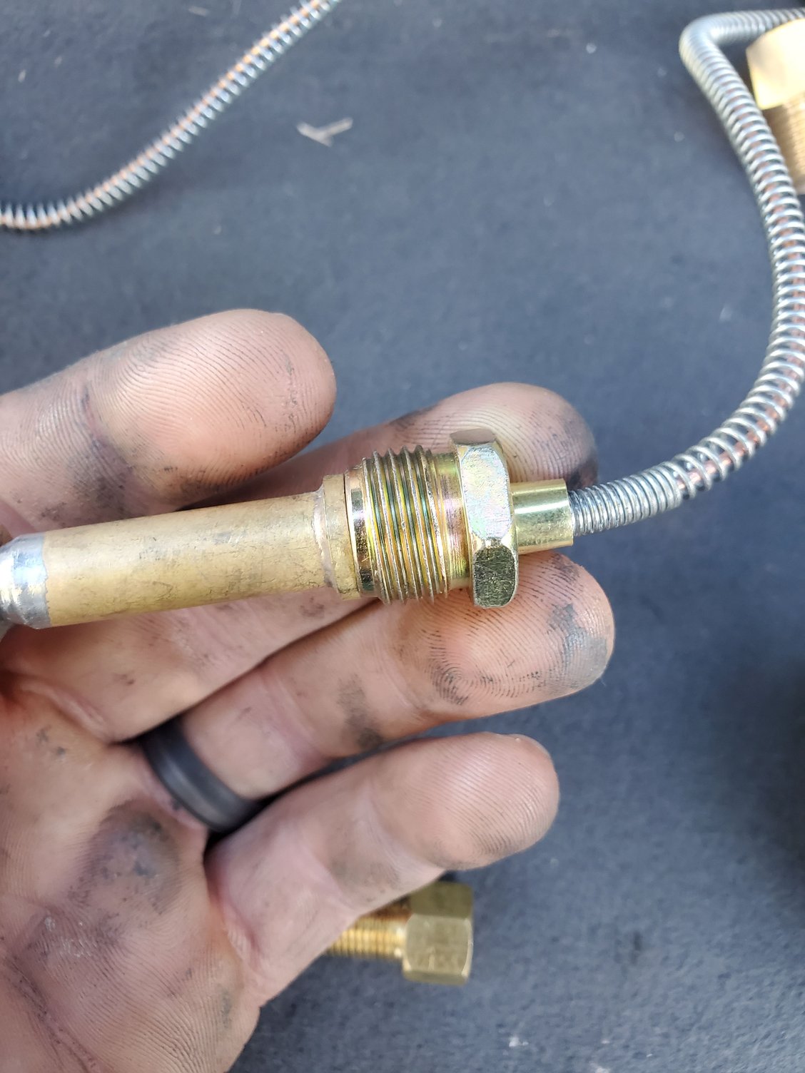

What analog temp guages is recommended for honda? I got a analog temp guage for my civic but the port on the side of the head is too small any suggestions? I've tried adapters everything can't seem to make anything work. Is their any guage company that make analog guages for honda.

Most of the aftermarket stuff is 1/8NPT. The Honda sender is 1/8BSPT. It's a difference of 27 threads per inch vs 28 but the diameter of the threads is the same. What sender did you buy?

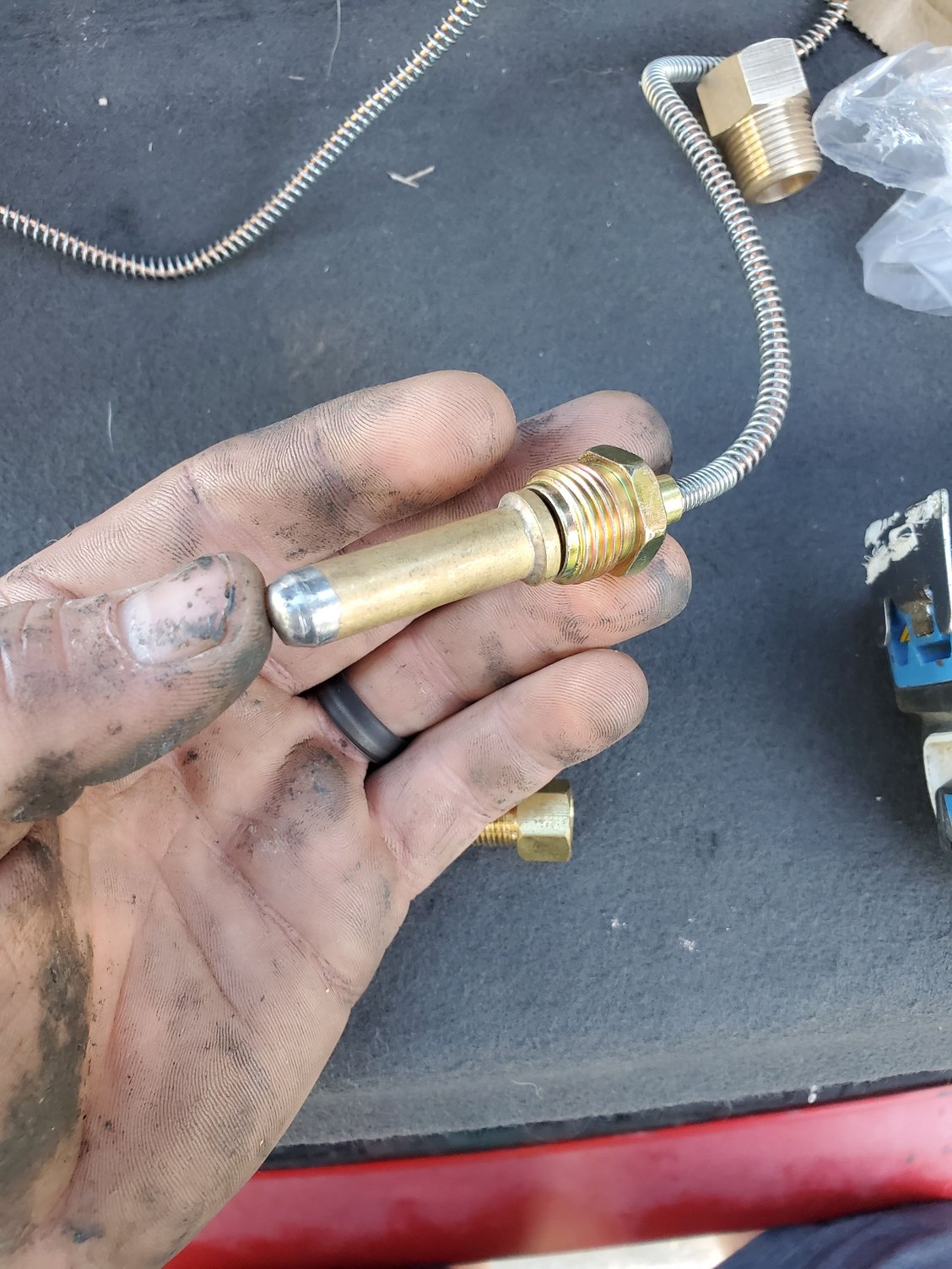

I bought a Bosch from my local autopart store but it was way bigger than expected

Im looking at getting this one tho cause the 1/8npt should work on thr port below the distributor

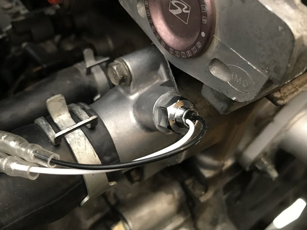

Yeah that’s pretty giant. I’ve seen someone drill out the boss on the upper water neck where the bleeder was on older models and mount the glowshift one there. Bonus points for keeping the stock sender too. I’ll see if I can dig up a link.

I ended up using that gauge, I just bought a inline adapter for my radiator hose and put that in and hid it the best way I could
