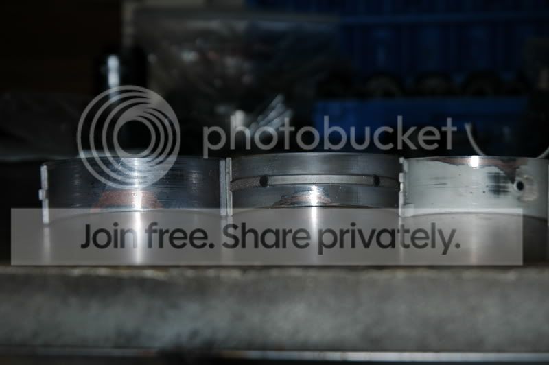

anyways, as far as ls bearing being bi-metal; mains are all the same on b-series (trimetal)
ls rod bearings; i was pretty sure they were trimetal also since they are pretty much the same thing as b16/b17 bearing but with an oil squirter hole on them.
i went and cut some bearings tonite, maybe to make this a little more informative,
found acl mains and rod and oem mains. i know i got some ls rod bearings somewhere, have to find them.
here is a pic of 2 mains and a rod bearing, acl, oem, acl
you can see the 3 layers

Thats awesome. At least there is one informative thing that came out of this post. I would really like to see an LS rod bearing.
