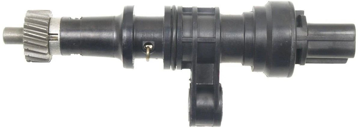

Replaced the vss with a cheap ebay one and it never fixed it, I pulled it off to maybe reseat it or check connection, and the little gear on the end of it wasn't even on it anymore, and must be somewhere in the transmission now. Fyi, it's the longer cylinder, 3 terminal sensor with the little gear towards the tip.

Pulled the new warrantied sensor out and spun it with a drill and it worked fine so transmission was thought to be the culprit. Turns out the speed sensor gear sits too low in the transmission to catch the transmission gear, and the speed sensor shaft has vertical play. I'm assuming the first ID I put it just luckily sat at the right height and then shifted down after driving around for a couple weeks, and the warrantied didn't sit at the right height from the get go. Must be a defect with the Import Direct brand speed sensor. Anyways, I have the speed sensor lifted with a washer on the bolt now and it seemed to fix it.
Just in case anyone else is having a problem and they are certain it is sensor related vs contact/electrical/cluster/etc. Check that your sensor's gear on the shaft sits at the right height in the transmission to catch the gear properly. Obviously this only applies to the 3 terminal with a gear on the shaft type sensor (which looking at the stock picture below, is probably where the gear is supposed to sit, but in reality, the shaft pulls down like 1/8-1/4 inch, which causes it to sit too low in the transmission, apparently:
