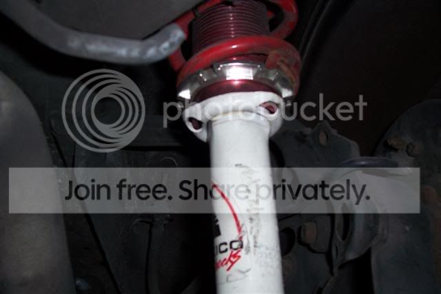

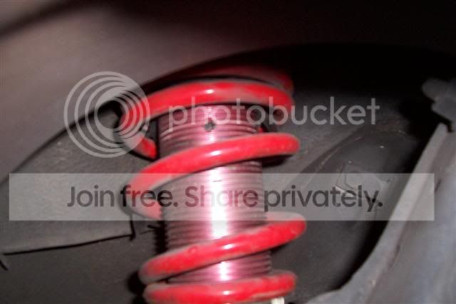

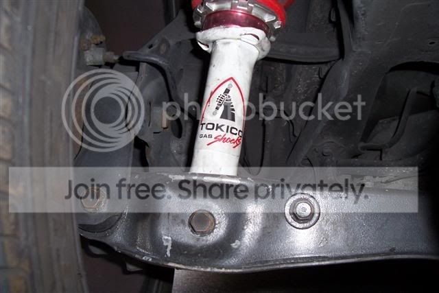

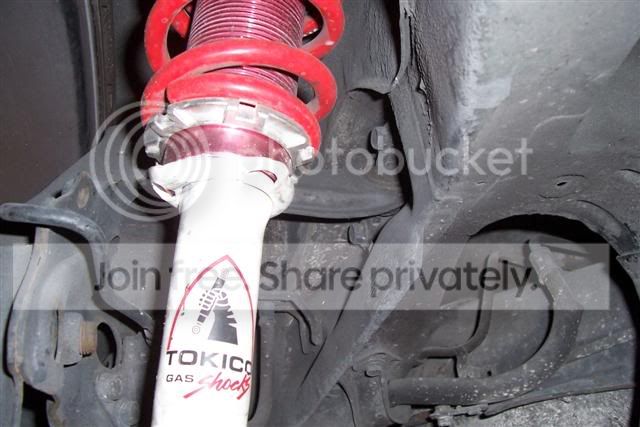

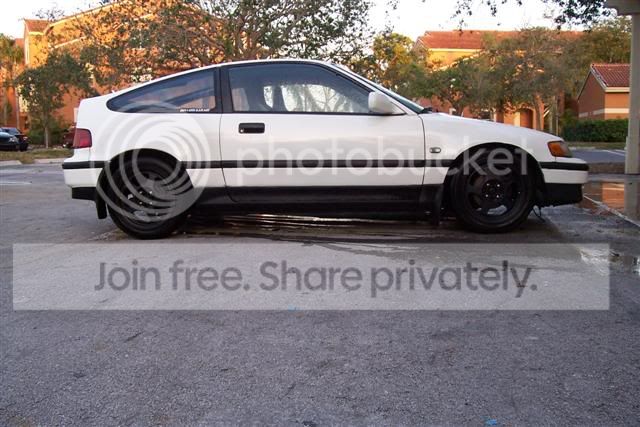

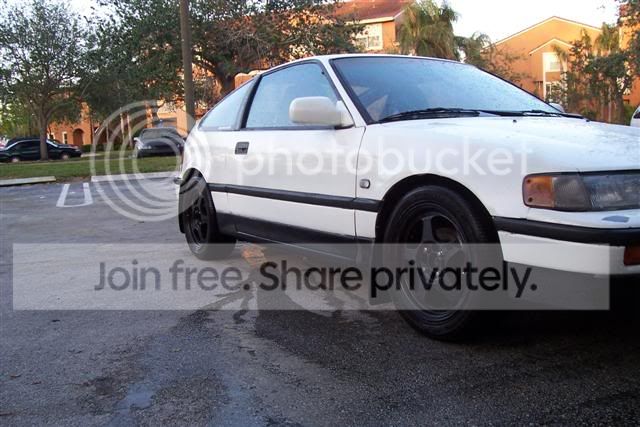

88 crx lower control arms with 5 way tokico. was going to just put on h&r race springs but couldnt...the spring didnt have anywhere to sit...so a coilover sleeve was put onto it which was stable and only put on 1 collar instead of the 2. ran it with the stock tophats. curious as to if this is how all 88 crx and itr rear struts look like. i did search but had trouble finding pictures. as far as i can tell the car is still as hell in the rear no matter if its on setting 1 or 5. the car does rotate quite well though so im not complaining on that. thanks in advance guys
edit: running oem bump stops and also the dust shield that covers the strut. (i have a feeling the cover shouldn't be on there and maybe the car is hitting the bumpstops?)

thank you sir, so if tysons picture is his "88" style strut...wonder what happened to mine.

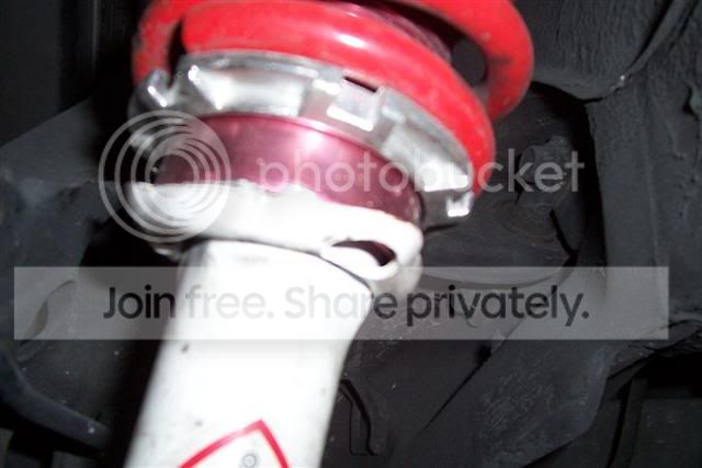

looks like someone cut the cup out. (isnt that obvious to you? i can even tell by the fuzzy pics someone took a hacksaw to it.)
ppl do that to get a little lower with the adjustable sleeve. which means they were running really low on those shocks. you got em used i guess?

thanks for moving it guys i ment to put it over here...yep used, it did look like how you said tyson i just didnt wanna say that and sound dumb rob how low can they handle. at the moment the springs are supposed to be a drop of 2" i nthe rear i believe. i can slide 2 finger between my 195/50/15 tire and the rear fender.

well you cant use the h&r springs you have installed like that. might as well put the other springs back on and set it at a reasonable height.
as far as how low the shocks can go, its not different than any normal shock. im just saying they obviously cut the shock so they can run lower, so the integrity of the shock as it is is totally in question. i hope you didnt pay a lot for em.
i think what you have it with the pics you shows is a good ride height.
