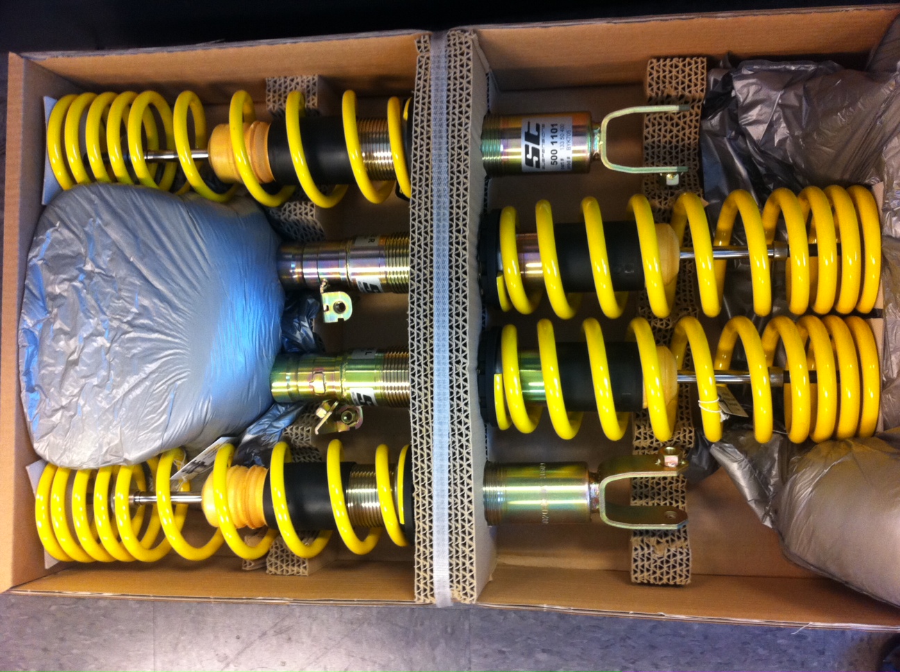

The picture you posted doesnt look like they're progressive springs. The combination of a tender spring and main spring make them progressive, somewhat. Looks like linear springs to me so they should have a measurable rate. Are they rebuildable/revalveable? Cost of rebuilding/revalving?

Here is the actual product in the packaging. Working the spring rates

Front 350 lbs/inch
Rear 150 lbs/inch
