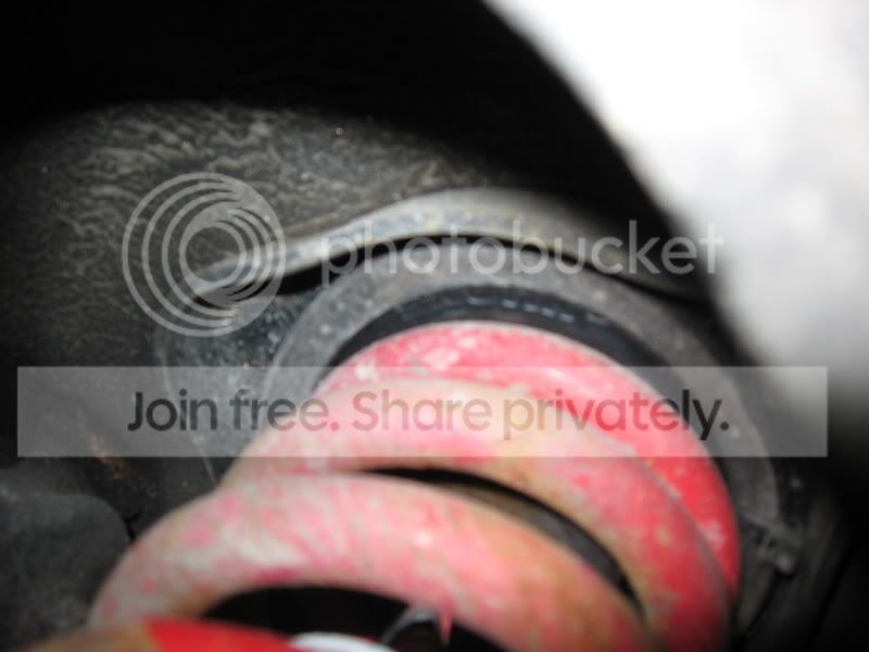

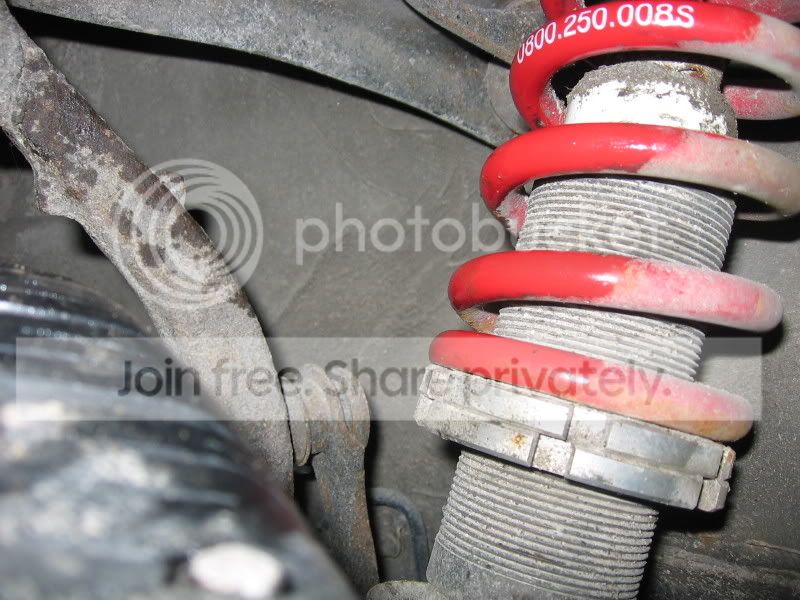

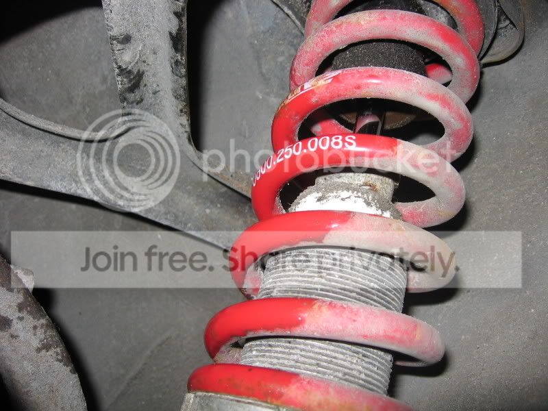

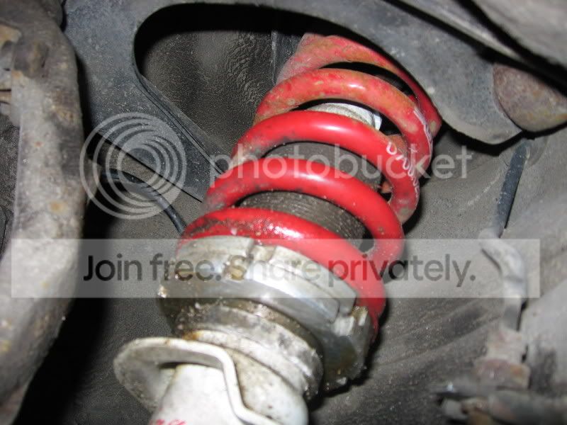

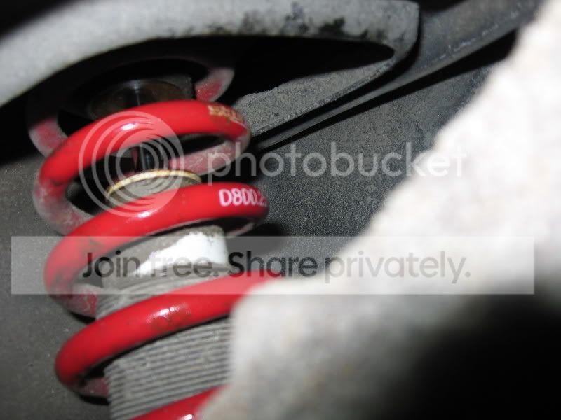

i dont understand what could be the problem but. i have lowered my skunk2's all the way down on my car and im not even tucking tire in the front. i dont understand?is something installed wrong maybe? the top hats? something i can check? usually i see guys tucking rim almost with skunk2's coilovers whats the problem here? here are some quick pics.excuse all the grim and dirt i live in canada.

You might need to replace new shock.. This shock is already blown, see the oil all over the coilover..

sup guys. i checked out my springs and the longer ones are in the back and the shorter ones are in the front. the ones up front measured to 7" and back springs are 8" is that right? or do i switch them.
