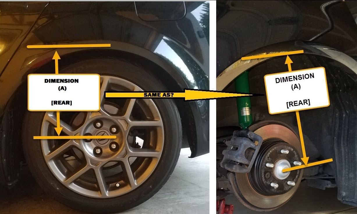

You can also use a measuring tape.
Like...measure the hub centre to fender arch while the car is on the ground before lifting it up to work on it.
Then, to make your marks, Jack up the LCA til you get the same hub centre to fender arch measurement.
The car will come off the jackstand too early if you jack up on the LCA too far inboard. So...measuring helps with accuracy.
