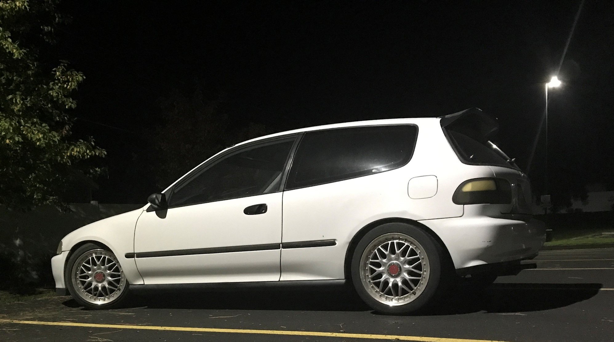

I've been running these in my EG since 2015. I'm pretty sure I was sold the 350f/250r and it's fine but I keep thinking I want to move the 350 to the rear and get 450 for the front. This car is mostly stock and daily driven. I set my lower spring perch to just snug up to the bottom of the spring, no compression and this is almost the perfect ride height. After my 5 lug swap is in and my new wheels are on, I'll probably lower the rear just a tad to fill out the wheel wells. Very happy with the quality and the longevity. Great support and the price if awesome for what you get.
