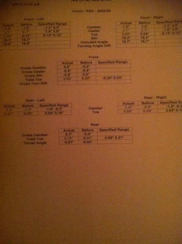

Do you happen to have your alignment specs before and after Pics? It would be awesome if you lived in so cal you could see the difference between laser and west end alignment.

Default Re: Lowering and Alignments
crappy iphone pic but you get the idea
current height. about 1 1/2 finger gap all around
