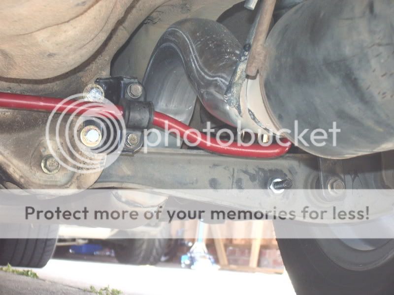

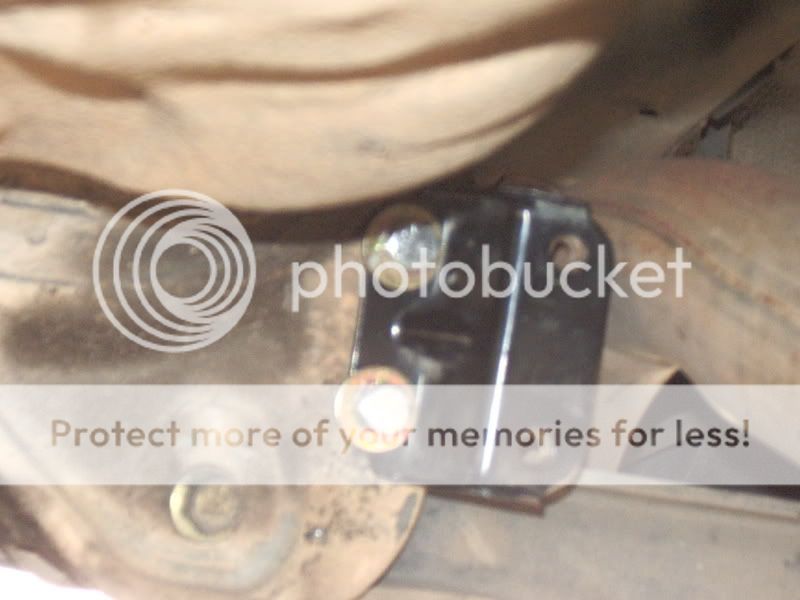

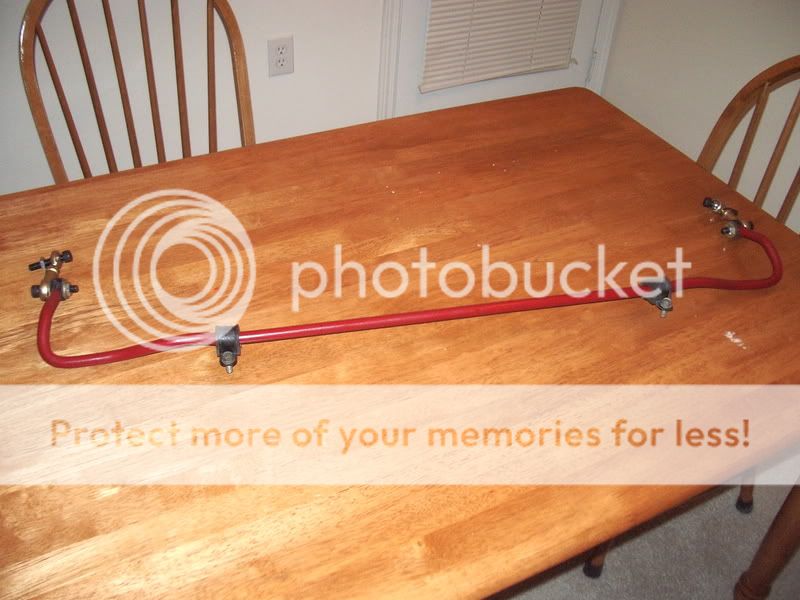

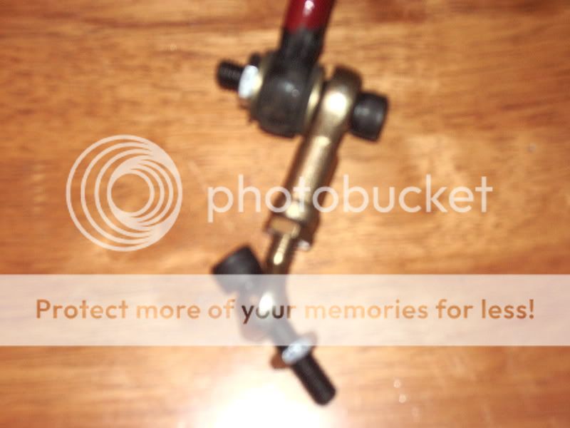

installed it today ran into a little problem though my custom exhaust was bent right in the way of the sway bar so i had to take it to my muffler guy to have him move it out of the way. heres the pics.
here is the sway bar and end links assembled
the blox end link
bracket bolted on car with the exhaust in the way
here it is all bolted up and installed
end link and bracket with the exhaust moved
its very self explanatory just bolt everything up.... hope this helps
