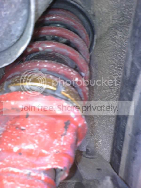

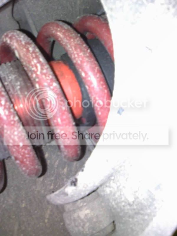

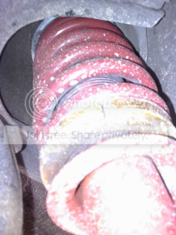

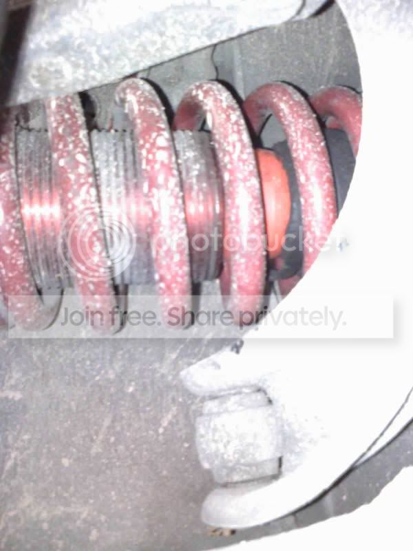

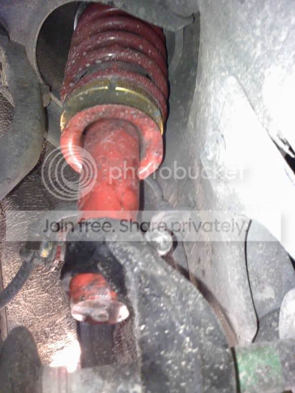

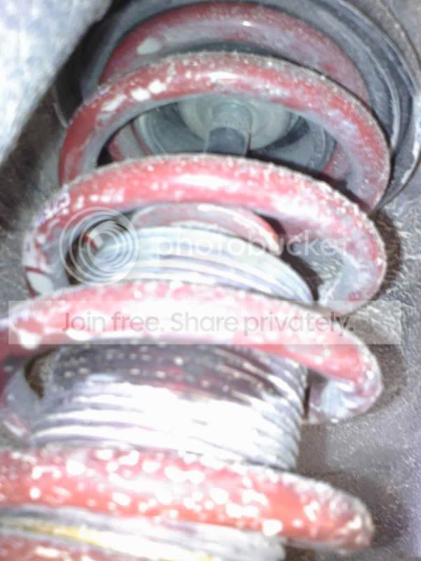

Old Jan 13, 2008 | 12:31 PM
JdmHatch4Lyfe's Avatar
Posts: 29
From: houston, tx, usa

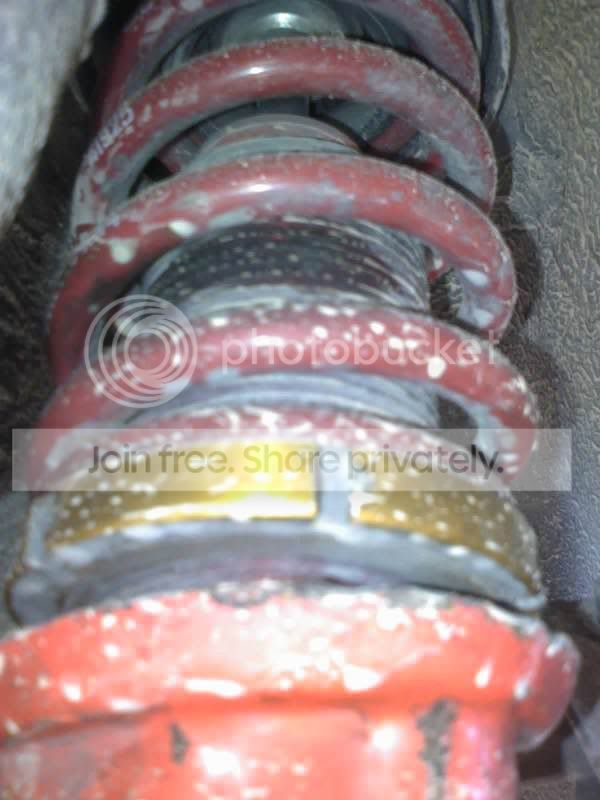

here are the pics. they are really dirty...it rained yesterday.
i couldnt find the numbers on the back one. but the front one had something like this on it.
54584 00200.6k.58 but i think the k may have been a 4. so like 00200.64.58. i cant see the back ones.
Old Jan 13, 2008 | 01:52 PM
Targa250R's Avatar
be professional
Joined: Oct 2002
Posts: 14,842
Likes: 13
From: Pittsburgh, PA
Default Re: (JdmHatch4Lyfe)
<TABLE WIDTH="90%" CELLSPACING=0 CELLPADDING=0 ALIGN=CENTER><TR><TD>Quote, originally posted by JdmHatch4Lyfe &raquo;</TD></TR><TR><TD CLASS="quote">00200.64.58</TD></TR></TABLE>
That's an 8" spring, 2.5" inner diameter, 325 lbs-in.
Some of your problem may be the 8" free length. I always recommend using 7" springs up front for an '88-91 Civic/CRX. A 7" spring will give you an additional inch of threads for adjustment on the sleeve.
How about a picture of the car's ride height?
But - what is that black thing up top in the front? Is that a dust boot, or is it part of the bump stop? If it's the bump stop, then obviously you've run out of shock compression travel, in which case you have a few options.
The rears look fine.

lets just put it this way...there is a one finger gap in the back between the tire and 1/4 panel and there is a 1.5-2 finger gap in between the tire and the front fender. its pretty high for being all the way down. and yes, that is part of the bump stop. i think i may just sell these with the shocks and all. and just get a new set. what do you recommend? i want the car to be alot lower so what would you recommend me getting? where can i get the 7" sleeve ground controls? and which shocks? koni yellows?
Old Jan 13, 2008 | 02:11 PM
Targa250R's Avatar
be professional
Joined: Oct 2002
Posts: 14,842
Likes: 13
If that's the bump stop, then you can obviously see what your problem is. Changing springs or shocks will not help.
You will need to trim the bump stops, or alternately pick up some Ground Control upper mounts for the front. If you trim the existing ones, do not leave less than 1" under any circumstances or you will damage your shocks.
If you want the car to be "a lot" lower, then you're going to have to bump up the spring rates "a lot" as well, which is going to make the car ride much rougher. You'll also be underdamped with the KYB AGX.
Perhaps you should look into air bags or air cylinders if looks are so important to you.
