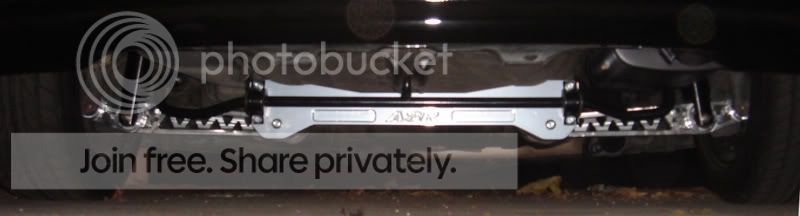

Actually with my setup I ended up buying the new BLOX endlinks (w/Heim joints) before I installed them because I saw the gap that the Function 7 endlinks have, thus making the gingeling sounds. The blox endlinks use longer bolts just as the f7's do (OEM endlinks use a smaller bolt & dont work with F7 lca's) but the BLOX endlinks have threads all the way down to the heim joint and are a very similiar design. Im very please with my new setup and its actually really quiet.
Function 7 LCA's
BLOX Endlinks
Function 7 Endlinks (made in china)
K-Sport's + ASR Brace + Function 7 LCA's + OEM 22mm Sway bar + Blox Endlinks =
Modified by Type Ek at 2:06 AM 8/11/2007

Having thread all the way "up" to the ball in the linkage is insignificant, if you have them that short, they will be too large of an angle and will bind. What "gap" are you talking about? Blox endlinks are probably made by some company in china too, maybe the Chinese government won't let them put "China" on it due to quality controls? &lt;shrug&gt;
Seriously, the blox endlinks looks JUST like the Function7s, but the important information like misalignment and load capacity are unknown, as is the type of "ball" and liner in that joint. Do a little research on Heim joints and you'll be surprised there are really cheap ones out there, and then really expensive.

The "GAP" that i am talking about is on the black bolt that goes through the heim joint. It doesnt have threads all the way down to the head of the bolt. The threads stop about 1/4 of the way before the head of the bolt leaving a "GAP".
My bloxs enlinks are not binding in any way. Also I did do my research on these joints and found that Function 7 doesnt even associate the Heim joints that they sell with quality function 7 products, like there lca's and such.
As quoted from Function7 on this locked thread: https://honda-tech.com/zero...13547
Yup, except the endlinks - we do not make these parts and so we don't really brand them as a Function7 product since they are universally available off-the-shelf components. As I mentioned earlier, we only made these kits available for the convenience of our customers who use them with our arms.
Plain and simple....."I AM NOT HAPPY WITH THE FUNCTION 7 ENDLINKS!"
